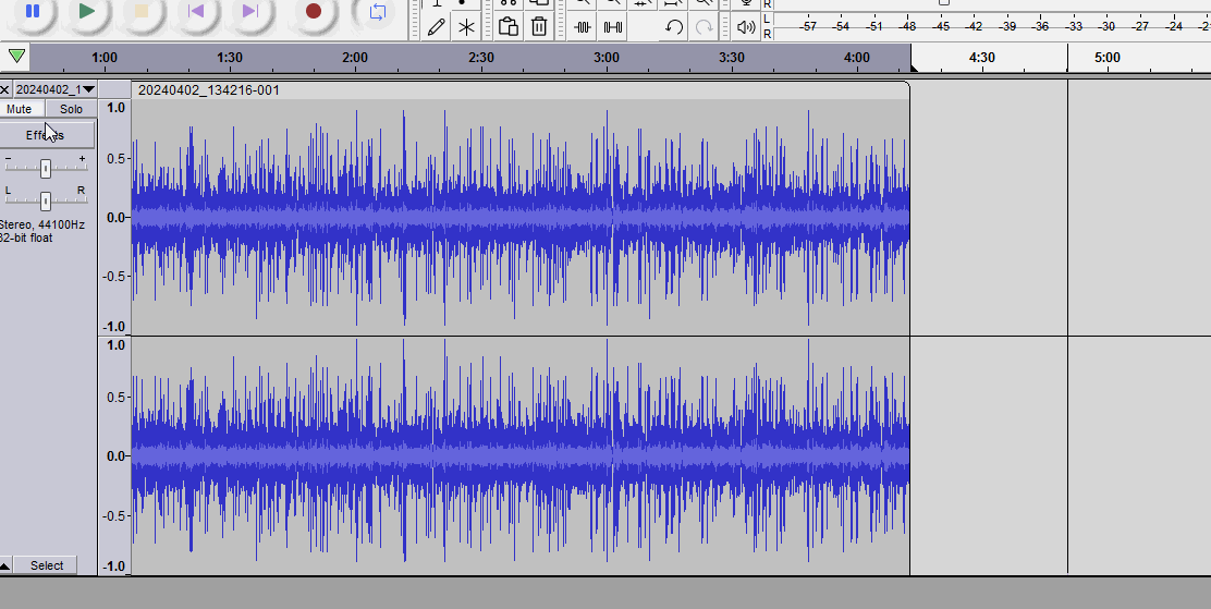

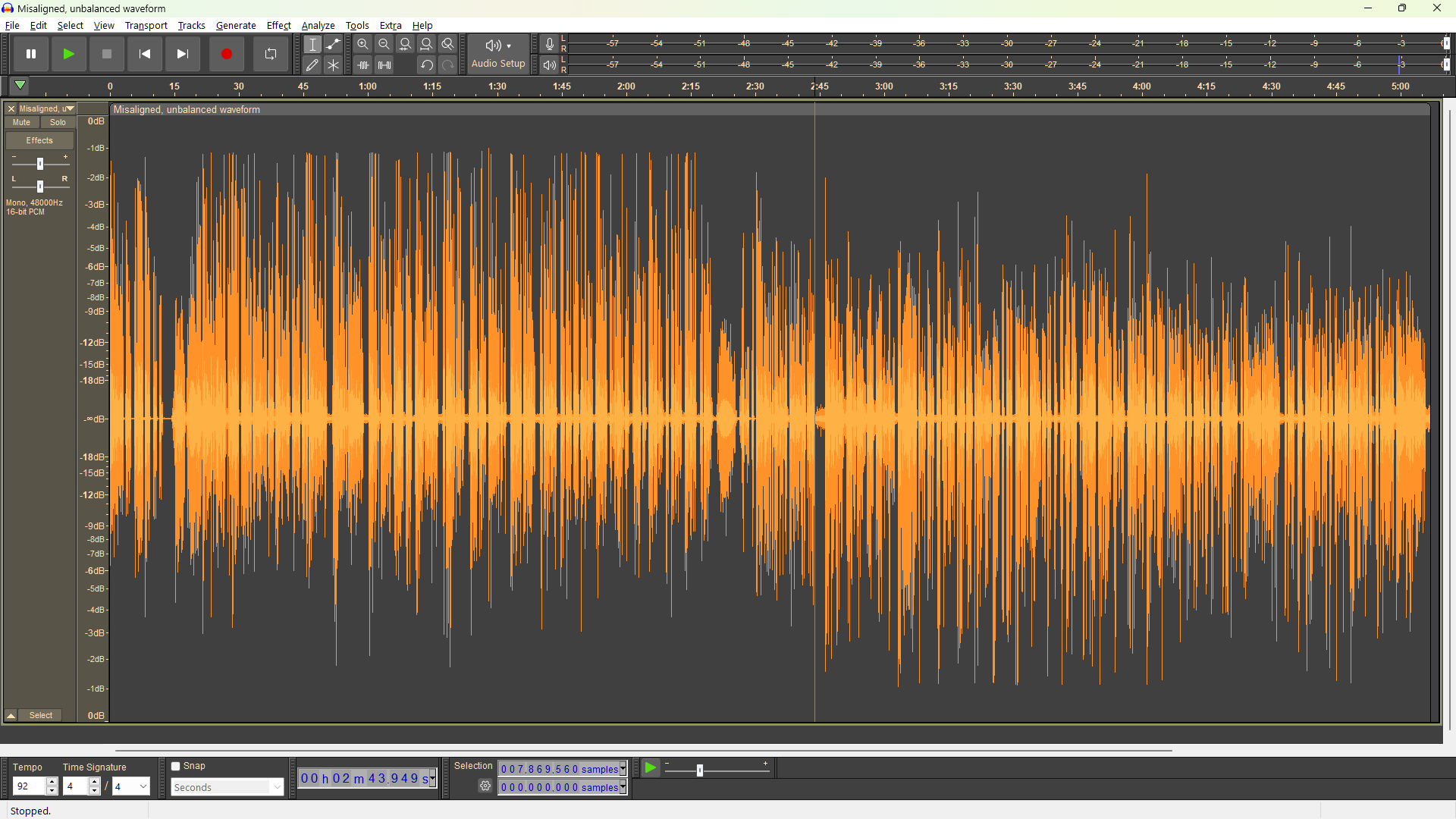

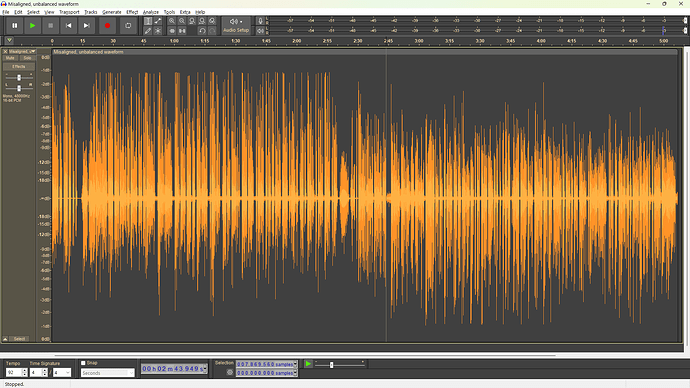

Take a good look at this image. I believe everyone here already knows this problem. But, how to solve it with Audacity?
The audio has DC Offset perfectly at ZERO, but the waveform curves (two people using different microphones) are sometimes more up than down and vice versa.

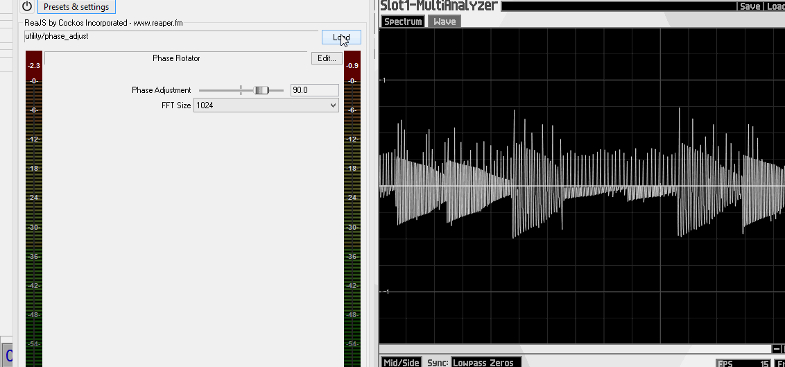

The free reaper plugins bundle includes a phase rotator which works in Audacity 2 & 3 …
phase-rotator-

I downloaded, installed, updated the plugin list… But it simply doesn’t appear in Audacity 3.4.2. What is the “magic” I must do to make Reaper appear in the Effect menu?
Please, Audacity developers, make a built-in plugin for Phase correction of asymmetrical (misaligned) waveforms
The phase rotator is part of “Real JS” which should be extracted into
C:\Program Files\Common Files\VST2
Real JS
Very thank you, Trebor.

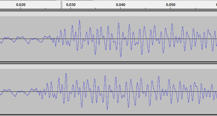

But the problem is that the plugin does not detect how many degrees the waveform is asymmetric. I have to experiment with trial and error. And after applying the plugin (rendering to a new track) a shift to the left (or right) is noticeable. In other words, it does not preserve the waveform in its temporal position. So I can’t use this plugin. Thank you very much for your effort in helping me, but I will have to look for another solution to this problem.
I really wish the Audacity developers would create a built-in effect to fix this very common problem. Do they read our suggestions on the forums?
That’s correctable: use the time shift tool to drag the new track so it matches the original.
