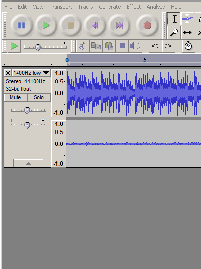

In the drop down that shows the items you specify,Mono, also left and right are “gray”, and won’t respond to mouse.

If you have a stereo file with one silent channel, the easiest thing to do is click Tracks from the main Window and select Stereo Track to Mono. Since this “averages” the left & right channels together, use the Amplify effect to bring-up the volume of the new mono track.
Or, if you select mono in the [u]Device Toolbar[/u] you should get a true mono recording.
Those options are greyed-out if you have two tracks [stereo].
If you chose “split stereo to mono” from the menu, then discard the the track you don’t want …

What do you have? One channel or two channels with one channel blank?

Once you’ve split to mono and you have two mono tracks, you can edit the tracks separately so you can select all of the audio from the “good” track and copy-and-paste to the other track.
Click the little drop-down arrows again to assign one track to to the left and the other to the right, and than again to “Make Stereo Track”
