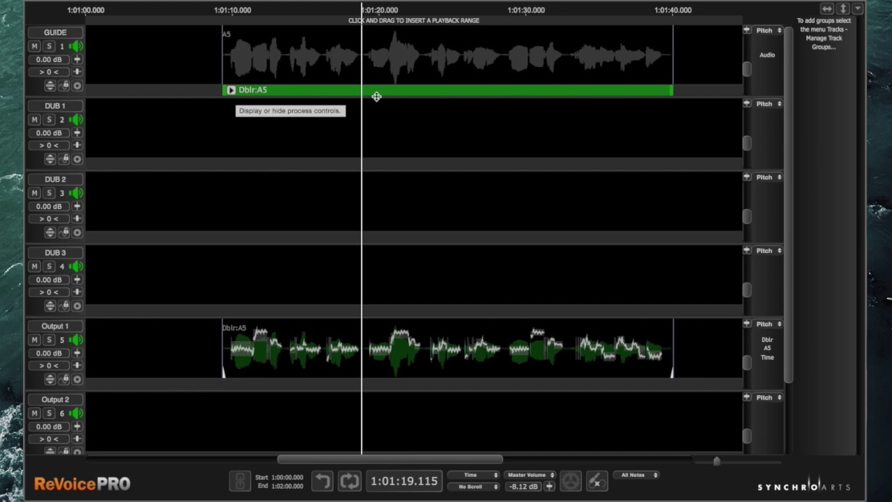

this video right here is what I am trying to do with my next project
