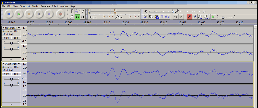

To align beats, zoom in (red square), time shift (green square), drag tracks into alignment.png
To drag track: press time shift tool (I’ve coloured it green above), place cursor on track, press left mouse button, then drag left or right using mouse to desired position, release left mouse button.
