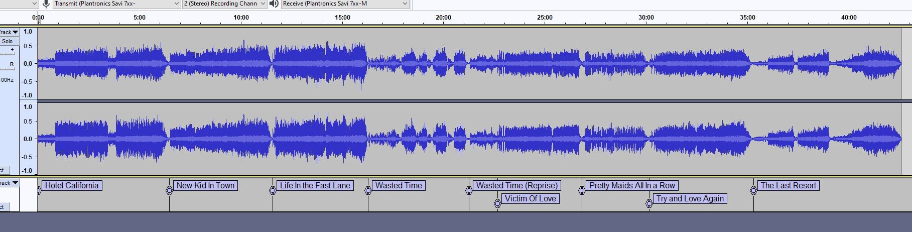

Here is an example of my recording for the Eagles “Hotel California” LP.
Attached is the Audacity recording project with the track labels added afterwards as well as the Export WAV file directory under Hotel California with all the tracks. Hope this helps.
Everything looks OK, is there still a problem?
If there is a problem and you’re using WAV files you might need a different format.
