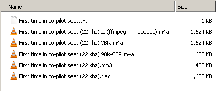

I was able to export a file using the M4A file type:
Notice the difference in file sizes in the figure above: 655k CBR vs 1624k using External command line.

BTW, the 1624k file I exported to M4A using `External Program´ command line is equivalent to the 1632k file exported in FLAC as follows:
So I assumed they were both lossless compressed, and don’t want to mis-advise the Mac user guy.

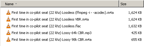

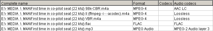

Would like to post the final `cleaned up´ file lists, as there were errors and inconsistencies in the file names during experiments. MediaInfo
The file names are self explanatory.
