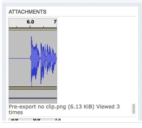

The audio is fine when played back in Audacity. No clipping. I then export the file as a WAV. When I open up the WAV file, there’s clipping all of a sudden.
As far as I can tell, I’m not doing anything. No gain, no nothing. Just exporting audio in a .aup3 project as a WAV.
I’m not mixing multiple tracks (if that’s what you mean by mixing).
I’m not exporting as MP3.
The levels are fine right before export. When I open the files after export, that’s when the clipping shows up. The original audio in the .aup3 project are still fine (no clipping).
I can hear it. Also, you can see it in the WAV form. See attached.

there’s no clipping in the .aup3 project.
There wouldn’t be. The AUP3 project file and Audacity itself work in 32-bit floating format. That means they don’t clip. People ask why on earth we did that. It’s not unusual to encounter a super-high volume condition in the middle of effects, filters, and processing. The Audiobook Mastering Suite sometimes does that mid-process.
Not to worry, the “damaged” audio is still up there waiting for you to bring it back down to normal. If you were doing that in 16-bit (WAV, MP3), that super loud sound would be permanently destroyed.
I think you’re suffering from advanced electronic magic. That waveform above does have overload damage at six-point-something seconds. It goes down instead of up. The instant that sound gets converted to 16-bit, that tiny segment starts making up its own sound. That’s what’s so darn much fun about clipping. It’s not just a quiet spot. It sounds crunchy, hurt-your-teeth, sharp, and loud.
