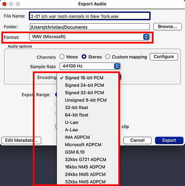

As you see below, you can select many variants of WAV in Audacity 3.6.4.

Anyway, I appreciate your answer but it does not resolve the matter. I know what export options are available as I use them all the time. The problem however is when using the export function within a macro. In that case it only exports to 16bit for me no matter what export settings I had previously used fom the file menu.
