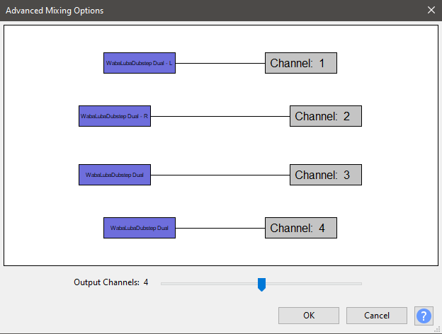

When i try to export a 4 channel project to .wav it wont give me a Quadrophonic, 5.1 or 7.1 surround option even tho .wav can fully support that
however when i try for a custom ac3 it does give me channel out options but when the exported file plays,

What happens? Do you get the “Advanced Mixing Options” window?

“What happens? Do you get the “Advanced Mixing Options” window?”
i get the advanced mixing options only on ac3, while im not even sure what that file is only vlc recognizes ac3, but even then the ac3 file plays as stereo in vlc, and vlc is set to use surround output

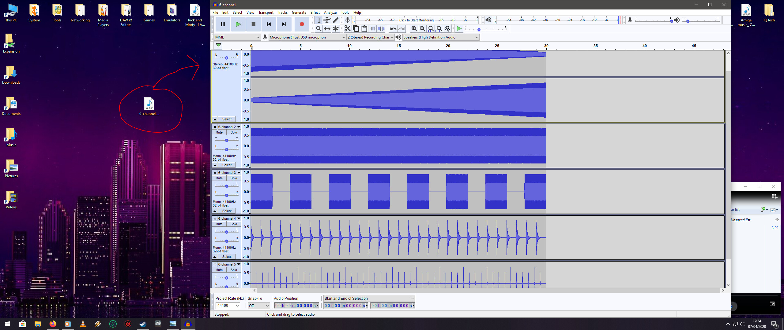

I’ve uploaded a 30 sec, 6 channel WAV file, with distinctly different sounds in each channel. Does this play on you computer?
yeah the file you uploaded plays trough all speakers , ofccourse there are 2 channels tot im not hearing as i have 4 channels less ^^

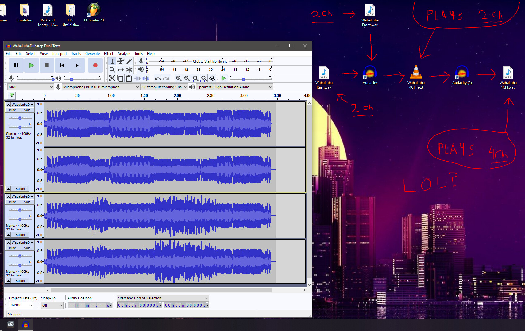

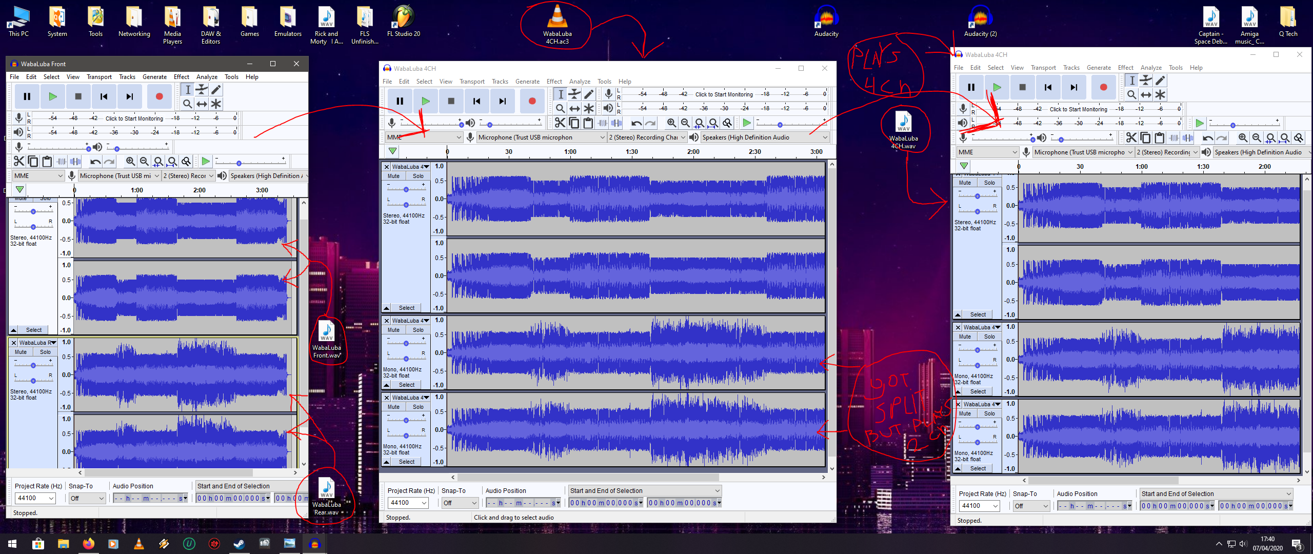

i just found out however (weird way around this al to make it work :/) if i make something in lets say FL studio for a quadrophonic setup, and i export in fls the front l/r as a wav file and then seperatly export the rear left and rear right as a .wav, then drag those two to audacity , then export that to ac3 (wich still plays as stereo even tho 4channel is selected) then open a new audacity instance, paste the exported ac3 file in there and export that ac3 file to a regular .wav 32bit float (without channel selection) that exported .wav plays as quadrophonic, both in vlc , winamp and even windows media player. this is probably not the normal way to do it , but that works for the moment :confused:
When you re-import the file do you see all 4 channels?

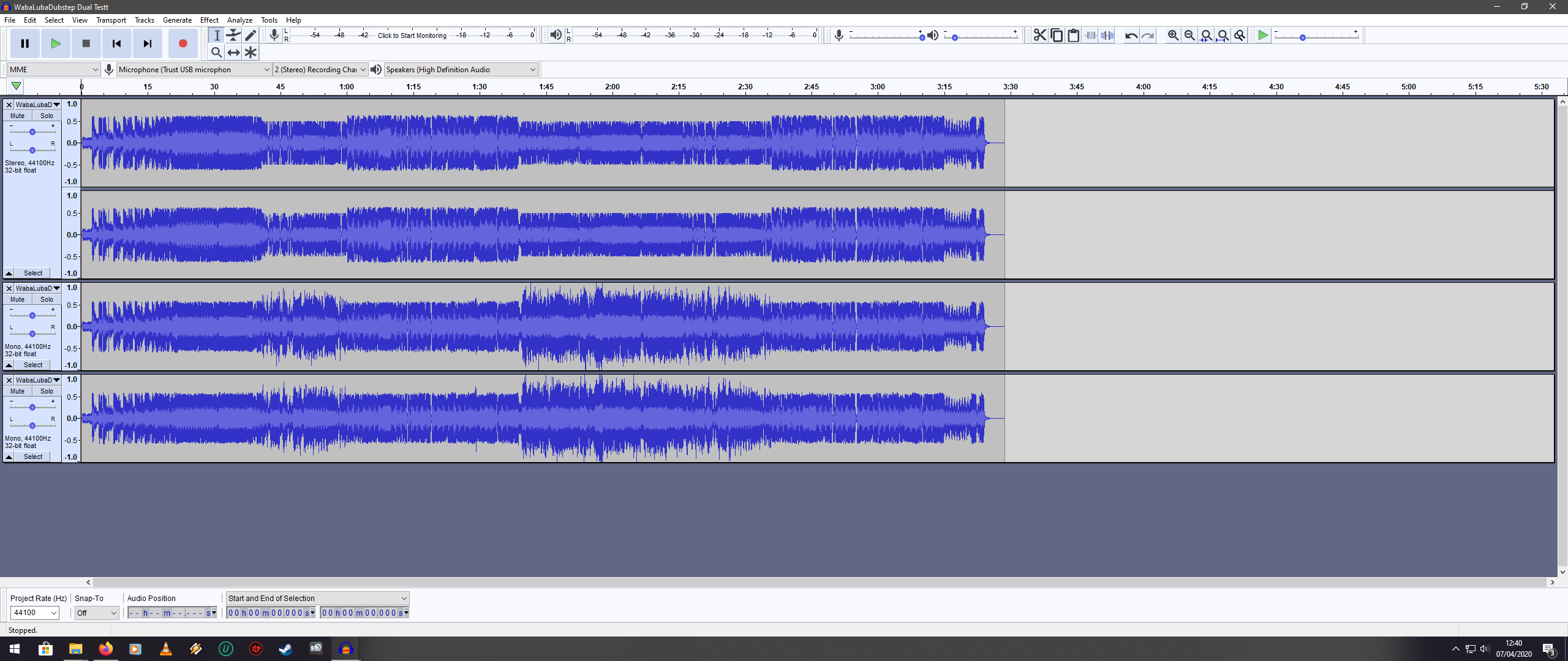

when i import the created ac3 file from audacity back into audacity i see 3 tracks, 1 is a stereo channel (for front L and front R) and 2 mono channels whereas 1 is for Rear l and the other for Rear R, so when it was exported to ac3 audacity automatically splitsed the stereo rear channel into 2 seperate mono channels , then when that ac3 was exported to .wav and i open that .wav in audacity its still the same, 1 track 2 channels and 2 tracks both 1 channel. :confused:
btw, this is your file that plays fine , viewed in audacity
As you can see, exporting multi-channel WAV files works fine for me, but I’m on Linux. Perhaps someone on Windows can have a go (DVDdoug ?)
