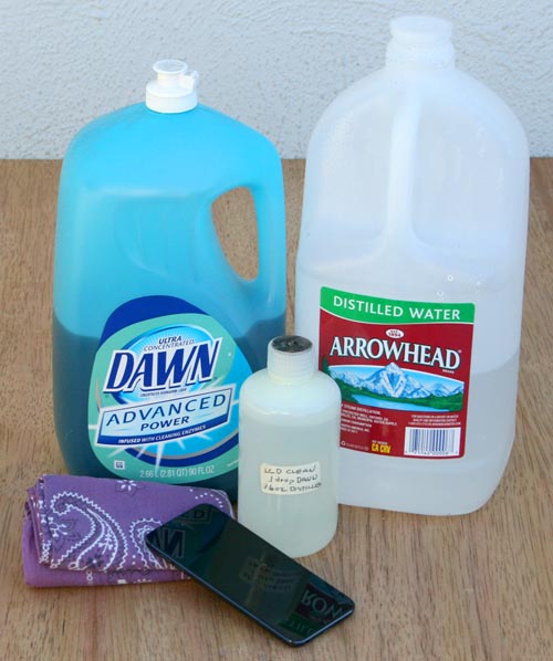

As a side project I make Koz’s Famous Cleaning Solution for Optical Surfaces. It’s 500ml drugstore distilled water with one (1) drop of Dawn unscented dishwashing detergent applied sparingly with a cotton “western” bandanna all in a Nalgene plastic bottle. It’s non-toxic, no alcohol and it dries to zero.
It works a treat on “i” devices. iPod, iPad, etc. and computer screens. If you make runny drips, you put too much on.
Clean the bandanna after several uses by swishing in the sink with more Dawn, rinse several times and do a final rinse with distilled in a bowl. No matter how many times you rinse in the sink, the distilled rinse will clear out more bubbles. Air dry. I throw it over a towel rack in the bath.
I use a purple bandanna. your mileage may vary. Consult your local listings.
Note: I get name-brand distilled now. I bought off-brand distilled once and it had That New Car Smell. I dumped it on the flowers.
Thanks for the tips. I’ve been using a microfiber cloth to clean the discs which hasn’t helped much. Will try using cotton and make up some of your famous mixture (hope there is no patent infringement issue) and hunt down a bandanna or two. Thanks again.
