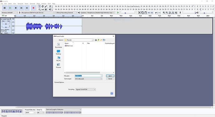

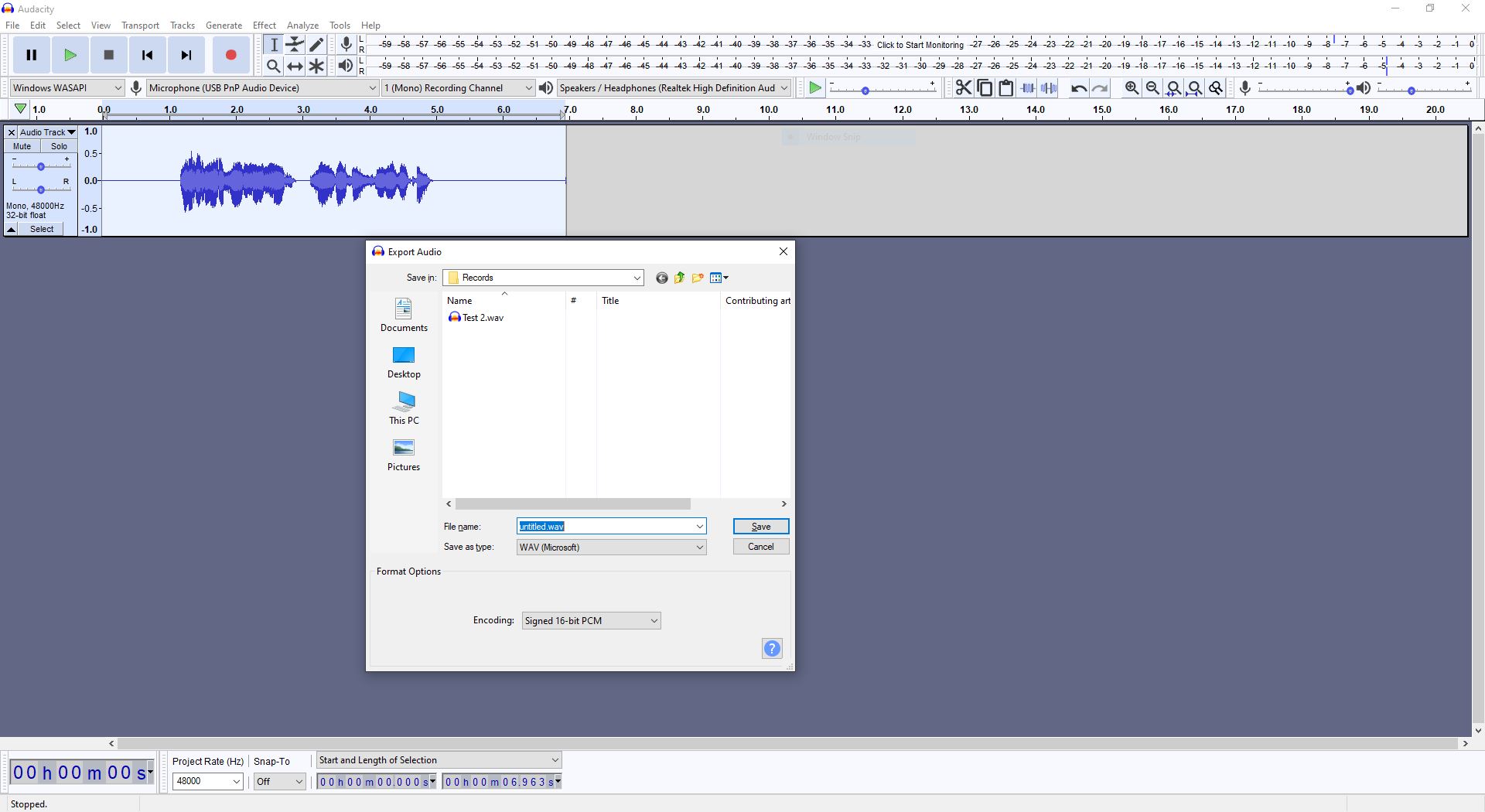

Let’s see if I can explain this without sounding totally incoherent.
I have a macro that ends with the “Export WAV” command. If I use the macro directly after recording in Audacity it will: Normalize, apply Noise Gate, apply Compression, apply Loudness Normalization, Play the audio, then bring up the Export to WAV dialog box to put in a folder destination and file name. All of this works fine and gives me the finished voice audio I am looking for.
What I don’t understand is if I import a file that already has a file name and run the same Macro, it will perform all aspects of the macro except for opening the Export to WAV dialog box.
Both are voice only recordings. The only exception is one was recorded directly in Audacity and the other was imported into Audacity. The recorder I used assigns it a date and time for a file name
2021-08-09 4-26 PM.m4a. I have changed the file name to exclude the dashes and spaces. Same result.
I have even copied the file to the desktop before importing it into Audacity. It does not matter what extension the recorded file has, the end results are the same. After the macro has run, I can click File and Export to WAV and the Export to dialog box opens immediately with that file name but with the .wav extension instead of m4a. It is obvious this would not overwrite the original file since they have different extensions, so is this some type of bug?
