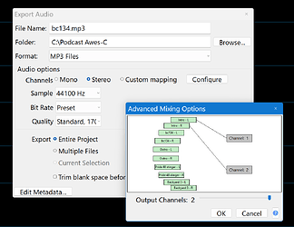

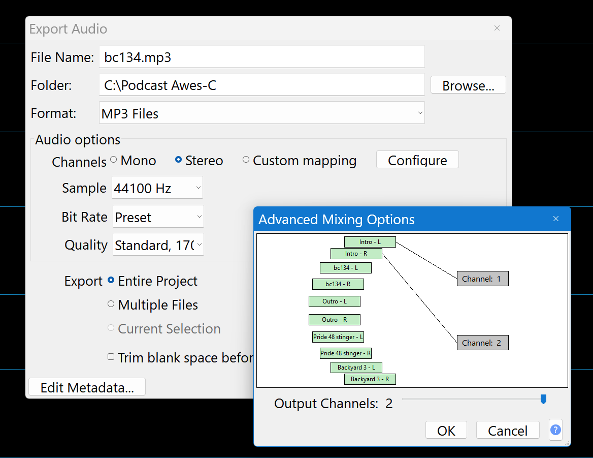

When you export, click on the Configure button and see if you get something like this image. If you do, not all the tracks are mapped to the left and right channels.
The configure button looked exactly like that. When I delete the .mp3 track and look at the config, it hasnt changed yet it exports properly. I reconfigured the map connecting multiple tracks to L and R channel… didnt change the outcome. What am I missing?

I wasnt expecting it to resolve the issue but I deleted that track and imported again, now I am hearing all the tracks in the export. The configure map looks the same, just pointing R and L channels to the 1st 2 tracks listed, not sure I understand why it wouldnt be mapped to all the tracks… but whatever. I was just going re-install the previous version I was working with and just leave it at that… if the problem resurfaces, thats what I will probably do.
