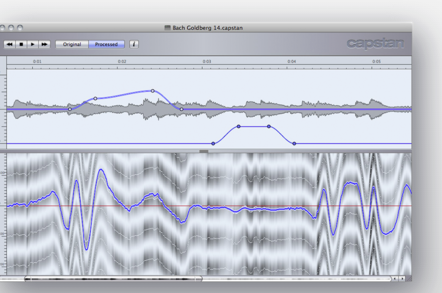

Celemony’s Capstan is very good but pretty expensive for software that you may use only a few times,
different of course if you do this kind of thing for a living.
There is a rent option, but needs that 'orrible iLok nonsense.
The demo version is also not really useful as it mutes after 7 seconds.

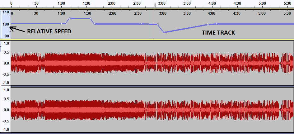

Audacity has a time track feature that can do a similar thing, of course don’t expect results as good.
but may be just enough for casual home use.
You can also then try the sliding stretch and EQ plugins.
