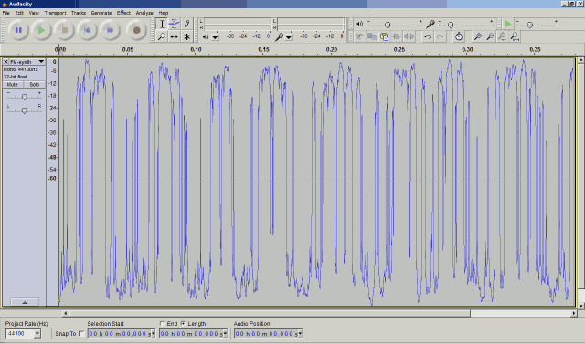

Is it possible to compress the waveform exponentially so it looks like when the vertical scale is in dB ? …
i.e. the amount of compression increases exponentially with the amplitude of the waveform.
Just a notion , I’m not sure how such a waveform will sound , other than loud , ( maybe square-wave-ish ? ).

Sorry, you know, Ican’t see the picture, therefore I’m a little bit lost.
The poster produced an animation where what looks like a normal voice performance wave is subsequently boosted in the quiet areas and crushed in the loud ones, both plus and minus – in short, a voice track well on its way to being a series of square waves.
I produced an almost identical wave shape using the widely reviled Effect > Leveler on its most severe, extreme setting.
So this is already written. We await the response.
What gave me the idea was I that I was faced with trying to correct recording of a keyboard where the wrong type of swell-pedal was used : an exponential one instead of a linear one. So I thought exponential compression could correct the overly loud sections. Using usual compression tools solved the problem , but I was still interested to experiment with exponential compression.
Just the simplest case without look-ahead, attack or decay is what I was after, however I think Koz has cracked it : applying leveller on the heaviest setting repeatedly (about 6 times) produces a very close match for the exponential compression …
It does sound somewhat different from square-wave : the rounded corners mean it doesn’t have as many harmonics,
it’s like an early computer-game.
