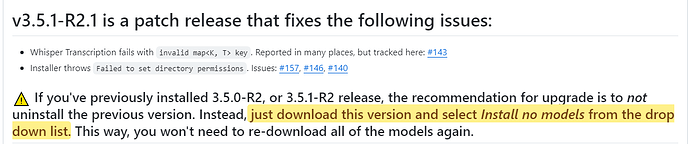

Hi @Ryguy ,
No, I haven’t checked that because the GitHub page from where I installed a new version of Openvion mentioned that you don’t need to select everything, just check, install no models, and proceed with the setup. Attaching image…
Let me know If I have to reinstall it and what should I check if I need to install it again.
Thanks
Hi @Afaq_Hassan,
Right, but in your case were you upgrading from one of the versions listed there (3.5.0-R2, 3.5.1-R2)?
If you were upgrading from the original plugin release (v3.4.2-R1), then you should go ahead and select the models.
I would recommend to just re-run the installer for the plugins, and select the models that you want.
Edit: And just to note, that the disclaimer there (about selecting ‘no models’) was added to save some folks some time by avoiding re-downloading some large model files. But, I think I need to change the wording or just remove this altogether, as I think it may just be causing confusion…
