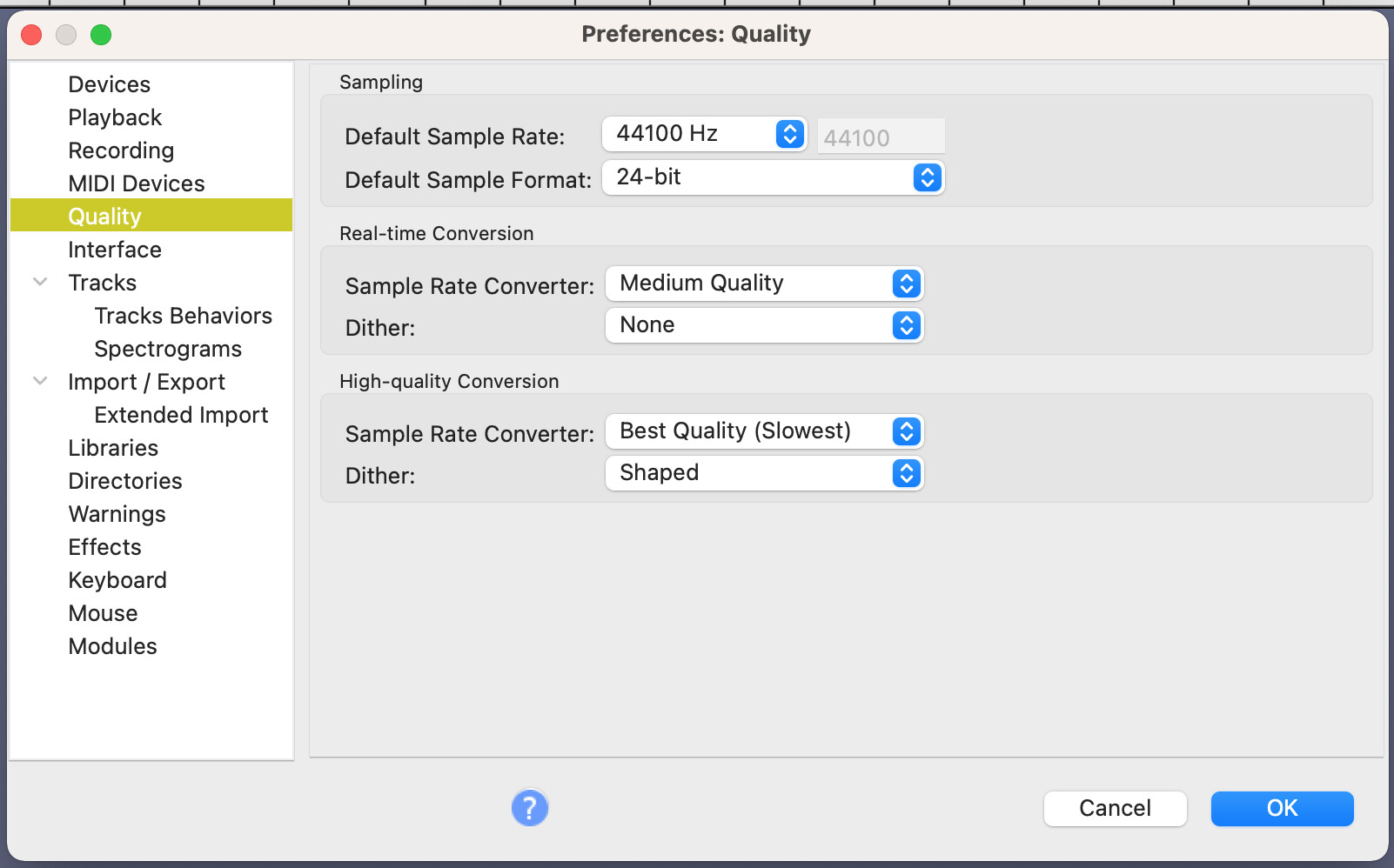

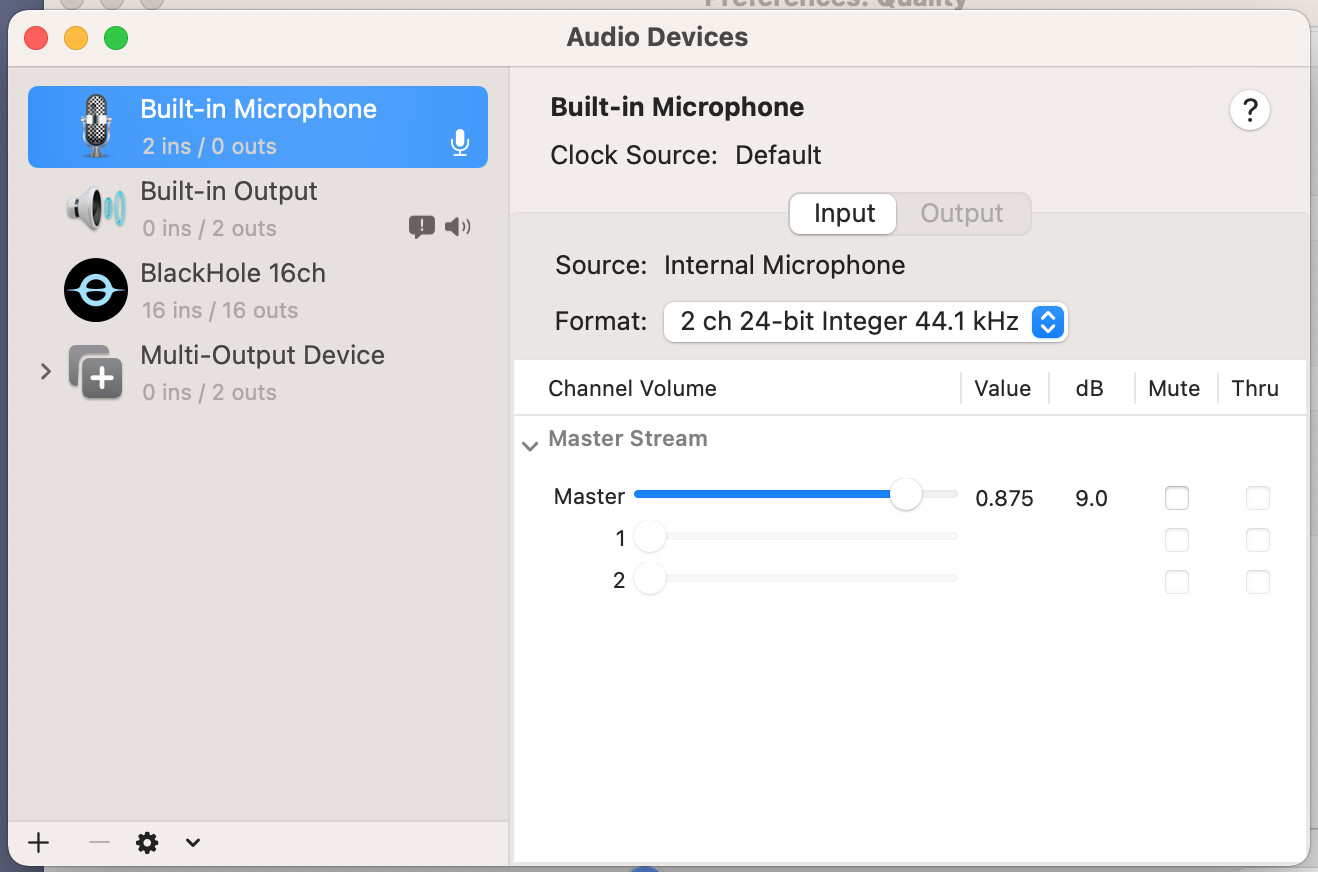

I checked the the sampling rate as the error suggests, and this is was I saw.
Try setting the input to 16-bit integer both in Audacity and in Audio MIDI Setup.

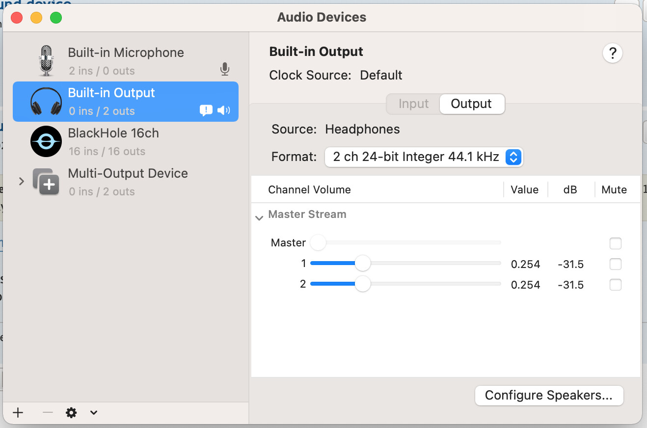

I assume that you are using “Built-in Output” for playback (?)
What are the settings for the “Built-in Output”?
As a test, please try removing “BlackHole” and the “Multi-Output device”.
I can’t easily remove BlackHole like I can the multi-output but pressing the minus sign, so I didn’t, but nothing changed when I removed the multi-output device.
Perhaps this is relevant. There’s nothing under “supported rates.”
