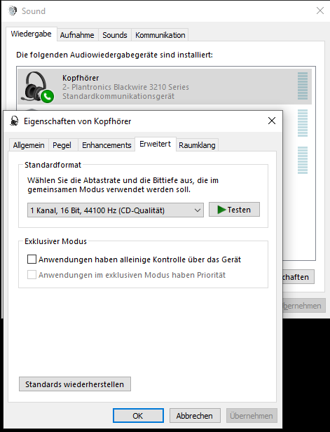

I checked the Windows sound panel (mmsys.cpl) and put the sample rate to 44100 (it was 48000) for play and recording
unchecked button “allow apps exclusive access to the audio device” for play and recording too.

Can this be changed to: “2 Kanal”?
