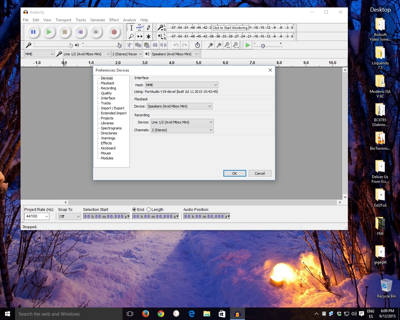

Hey hey hey … hey
Something really strange happened …
after the foregoing, I enabled both cards and I decided to do a last test, …so I set the mbox mini as default (right click over the left down audio icon > playback devices … Recording devices > select mbox mini and set as default.) … I started Audacity, and recognized everything!!! … so I set back internal card as default, and audacity recognized everything too!!!
My conclusion is that the last things I did have nothing to do with it, but when I disabled and enabled the internal MB card in BIOS, something was moved (may be the order they are loaded, Or windows 10 reinstalled the drivers … I don’t know) … but now it’s working with both!!!
Now I’m happy for Me, I hope everyone else solve this soon, I don’t think I have any solution, but for now you can tray to unplug (USB or PCI) or disable, cards in BIOS, start windows, turn off windows again, Plug-in or enable your cards again, start windows, and see what happen.
