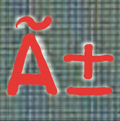

When Export2: … Filename=“’ + my_new_string + '.wav” … what Audacity actually do is saving the file as a caracter I don’t how to reproduce here but attached picture.
I don’t know what it means (if Audacity is able to understand byte and then decode himself) but works.
And when went to the folder to see the name of the file it’s writted with “ñ” !!!
