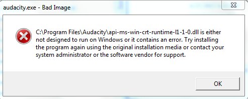

Thank you for your reply. I tried re-installing 2.3.3 and this is what I get when I run it as a Administrator or not.Please see Screen Capture attachment Audacity.jpg.
“api-ms-win-runtime-|1-1-0.dll” is part of Windows. It is the “Microsoft Visual C++ Redistributable for Visual Studio”.
Your computer’s version is too old.
The update is available from Microsoft: https://www.microsoft.com/en-us/download/details.aspx?id=48145
Note that for Windows 7, you must have Service Pack 1 (SP1) installed. https://www.microsoft.com/en-us/download/details.aspx?id=36805

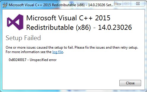

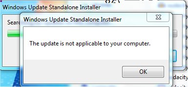

Hi Steve, I tried to do as you suggested, but I get these two Errors when doing so. See Screen captures.
Do you have Service Pack 1 (SP1) installed?
