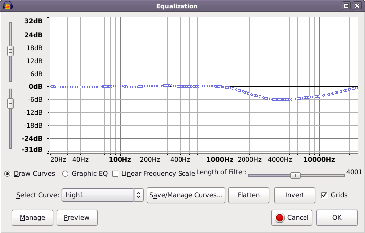

The Squeeze curves were also the nice blue line. The curves I imported from Squeeze now look like a coil even though the ‘Draw Curves’ option is selected. When I click on that option the line changes to the blue but the setting doesn’t stick. Next custom curve is a coil again. I have tried re-saving but no joy.

No green coil here. It’s blue! Changing the ‘Length of Filter’ setting looked weird and didn’t restore that blue line.

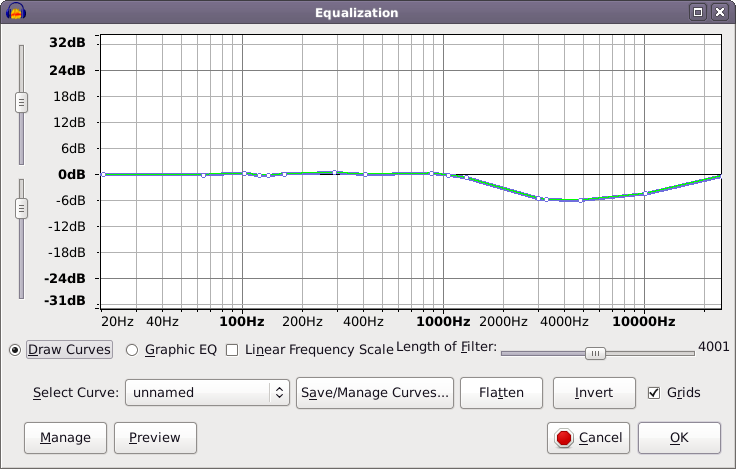

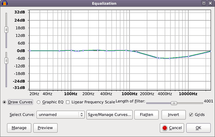

If I click on ‘Draw Curves’ it changes to this which is what I’m used to seeing but loses the filter name. I’ve tried resaving it but it still reverts to the blue coil.
Stay in the one mode rather than switching, because the modes are not identical. A curve created in Draw Curves, then switched to Graphic EQ and back to Draw Curves will acquire many more control points.
In “Graphic EQ” mode, built-in presets will display as “unnamed” because they were built using the differently calculated “Draw curves” mode.
Your own saved presets will always display with their saved name if loaded in the same mode you saved them in. In “Graphic EQ” mode, only presets saved in that mode will display with their saved name. In “Draw Curves” mode, a curve created in “Graphic EQ” mode can be displayed as its saved name if loaded from within “Draw Curves”. If that curve is loaded in “Graphic EQ” mode and then switched to “Draw Curves”, it will display as “unnamed”.
Well, in Squeeze’s Audacity those presets looked identical in either mode so I had no idea of the subtle differences between them. I can’t even remember how I built them - it was so many years ago. But I must have done it in Graphic EQ mode since they display correctly there.
I have switched back and forth between those two options and loaded several of my presets and they always display with the correct name unless I make an adjustment to the filter. Then the name switches to unnamed.
