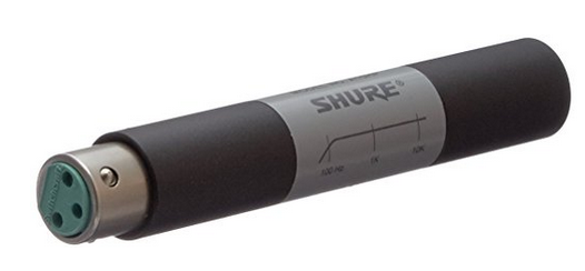

The preset is intended as a sister to the 100Hz cut filter available on many sound mixers. It also comes as a stand-alone add-on device.
It’s a popular eq curve.
