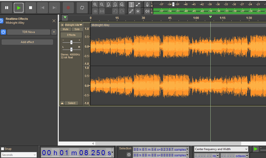

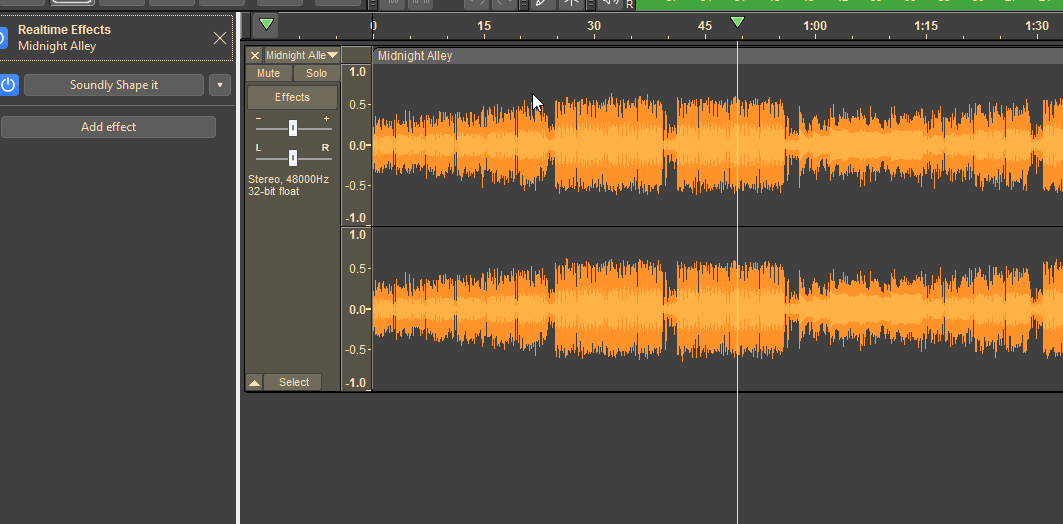

There are better curve EQs to be had for free …
Soundly Shape It … https://getsoundly.com/tools/
TDR Nova (free version) … TDR Nova | Tokyo Dawn Records
These EQ plugins work in realtime, unlike Audcaity’s native EQ.

I beg to differ …
soundly shapeit
https://support.audacityteam.org/audio-editing/using-realtime-effects
Ditto for TDR Nova …
TDR Nova VST3-
:light_bulb: Man, thank you. I am old and stupid. Lol. Did not know that i can open there TDR Nova in real-time-function :person_facepalming: (where is the head banging against the wall-smiley?).
Still i fight with the popup-window, but this tip is worth a lot :+1:
Returning here rapidly only for to tell you that i installed meanwhile the Shapeit-EQ too and i like it. A little more complicated than the TDR, but more bands. TY for the hint :+1:
