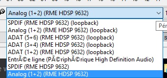

Je remercie le modérateur pour son message. Le problème est que j’avais déjà sélectionné l’hôte Windows Wasapi et essayé toutes les options. Aucune ne permet d’enregistrer l’audio audible sur un site consacré à l’apprentissage de langues étrangères notamment.
Que peut-on faire alors?

Have you showed us all your recording devices?
You have to choose the (loopback) recording device for the same device you are using to play the audio.
If you are playing the sound on High Definition Audio which I assume is the built-in sound card, you should have a recording device “High Definition Audio (loopback)”.
Did you install Windows 10 on this machine over a previous version of Windows? If so then for the built-in sound device you need to go the computer manufacturer’s web site and look for Windows 10 audio drivers for your particular computer model. If you built the computer yourself, go to the motherboard manufacturer’s web site.
Is your RME device intended to work with Windows 10? Have you been to their site to obtain drivers for Windows 10?
