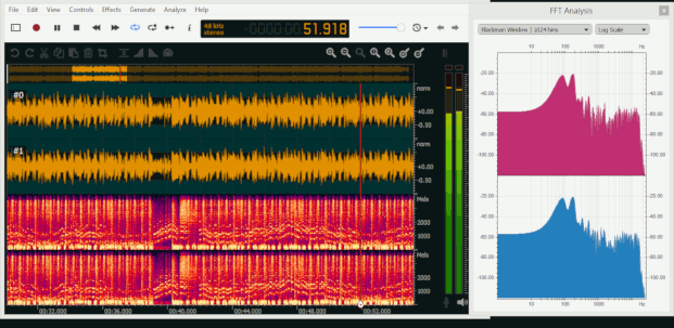

Thank you for your reply. I tried them. They don’t quite do what I’m requesting. Specifically, they can’t do points 1 and 2
OCENaudio-wee
https://www.ocenaudio.com/
