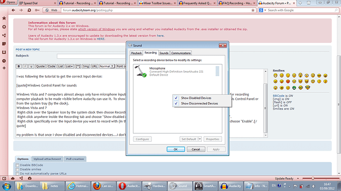

my problem is that once I show disabled and disconnected devices…I don’t have any more devices. I have only my microphone and nothing else. What am I supposed to do to enable recording off the web or other playing audio?
I’m attaching a screenshot just so you can see what I’m talking about

It may not have been worded strongly enough in the text, but some computers can’t do this. You follow all the instructions and the software just isn’t there. For you there’s the software and processes at the bottom of this series of instructions. If you’re on a laptop, chances are good that the loopback cable isn’t going to work and you need to add or buy additional software.
http://manual.audacityteam.org/o/man/tutorial_recording_computer_playback_on_windows.html
Self recording is not a guaranteed service like recording a microphone or listening to YouTube and some increasingly large number of computers just can’t do it by themselves.

Once again it is not Microsoft who remove stereo mix, but largely the choice of the computer and/or motherboard manufacturers.
Microsoft (under the WASAPI API) explicitly provide a method on Vista and 7 for applications to record computer playback even if the sound device does not support stereo mix recording, but Audacity cannot use that method because it does not support WASAPI.
