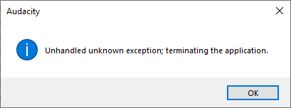

So everything seemed successful until I tried launching Audacity from there and I got this:
(Unhandled unknown exception; terminating the application)
And that’s as far as I got. My compiled version of Audacity does not start.
