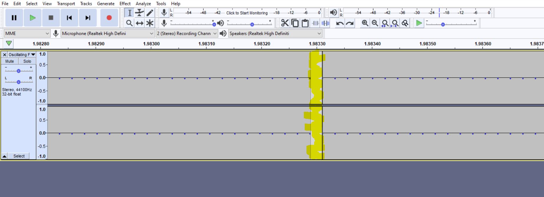

Need your help. I have been making audios for a few weeks and I have a weird issue. If I take any audio, goto effect, and repeat, there is a gap that’s created between the 2. I have done this 100 times and never seen a gap like this. This empty gap will not go away even if I delete or truncate. Please look at the attachment to see what I mean.
The gap interrupts the audio with a click sound. Even when I export it’s still there.
Any idea how I can remove this empty gap?
Left mouse button click on the bold line on the right of that “gap”.
Note that it’s not really a gap. It’s just a “split” separating two adjacent audio clips. Digital audio is just a series of discrete “sample” points. The line that joins the dots does not exist in the audio, that’s just a graphical addition to help visualize the waveform. There’s actually a “gap” between every sample point, but Audacity may show a line connecting them.

Thanks for the reply. I understand exactly what you mean and it makes total sense. I have been doing editing like this (repeat and remove gaps and align sound perfectly).
But I do still hear a slight dud sound. I have attached the 3-sec audio. It is a slight dud, but it still bothers me. Again, I have made countless audios like this for my youtube channel, the first time I am seeing an empty gap and dud sound even if the audio is aligned perfectly.

You can remove the empty gap by selecting the time-shift tool, then clicking and dragging the waveform on the right until it joins up with that on the left.
