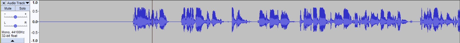

Welp, I did it. All thanks to you.
I got a clip to finally pass ACX-Check on my own.

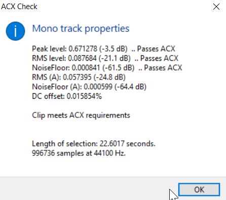

Here is the recording, proof and levels after RMS Noise, Limiter and Noise Reduction 9, 6, 6.
Though, at max volume I still hear moving air at about -54 dB.
Sound proofing still to come!

61.5dB is not a lot of elbow room. You fall off at 60 and 1.5dB is really tiny. That’s probably why you can still hear some noise if you listen carefully.

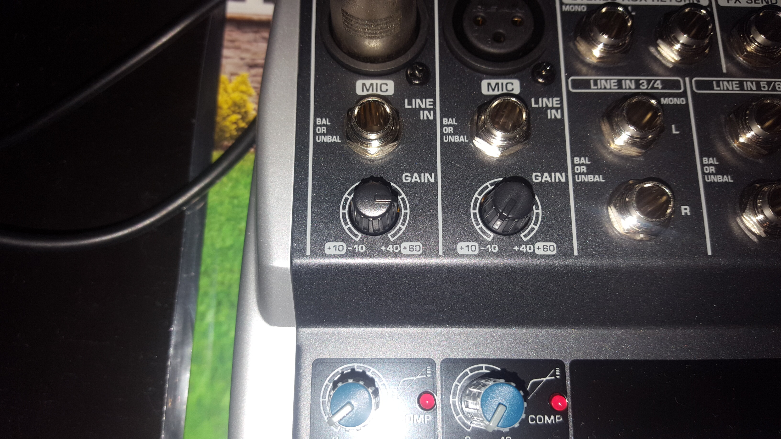

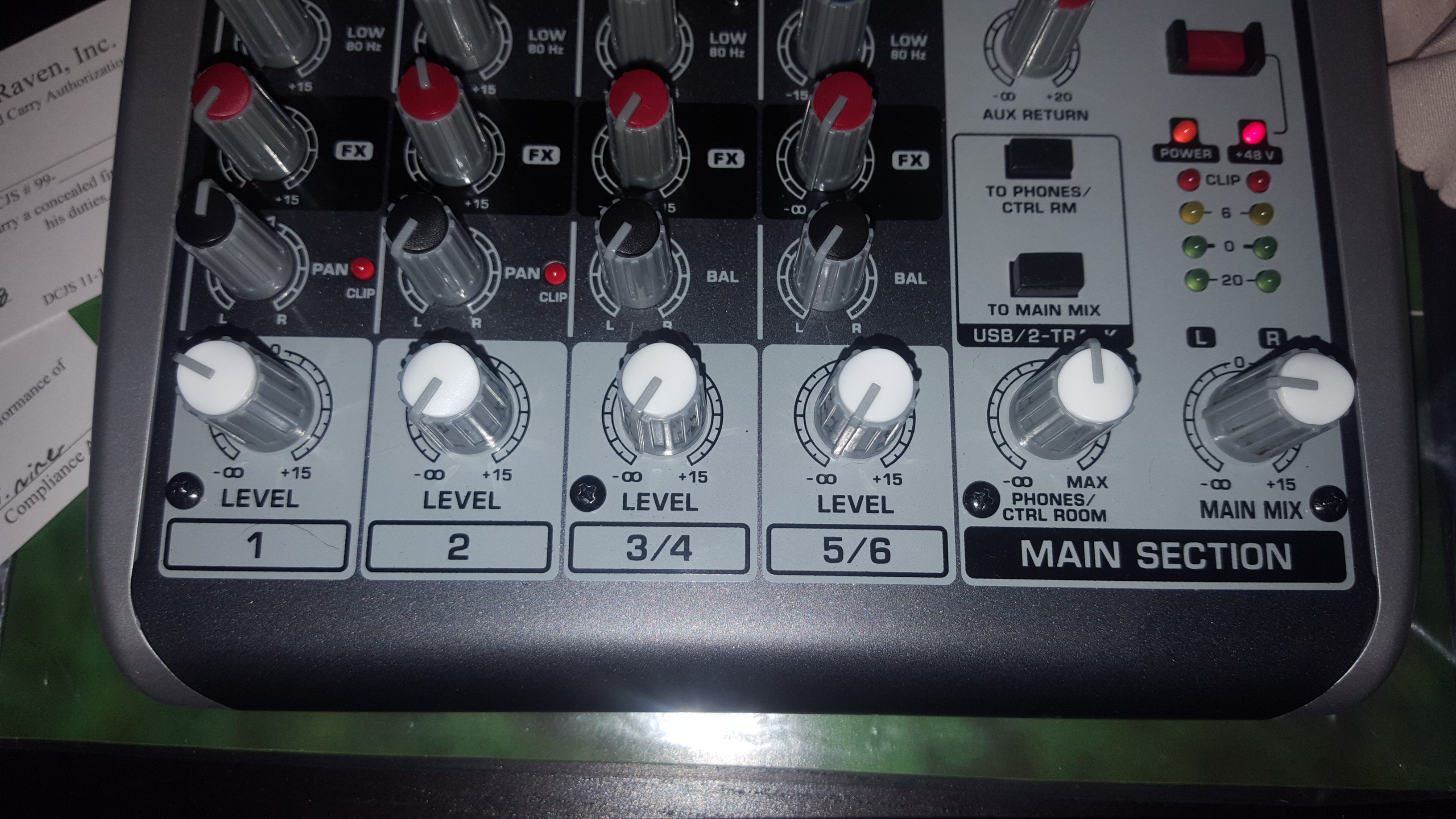

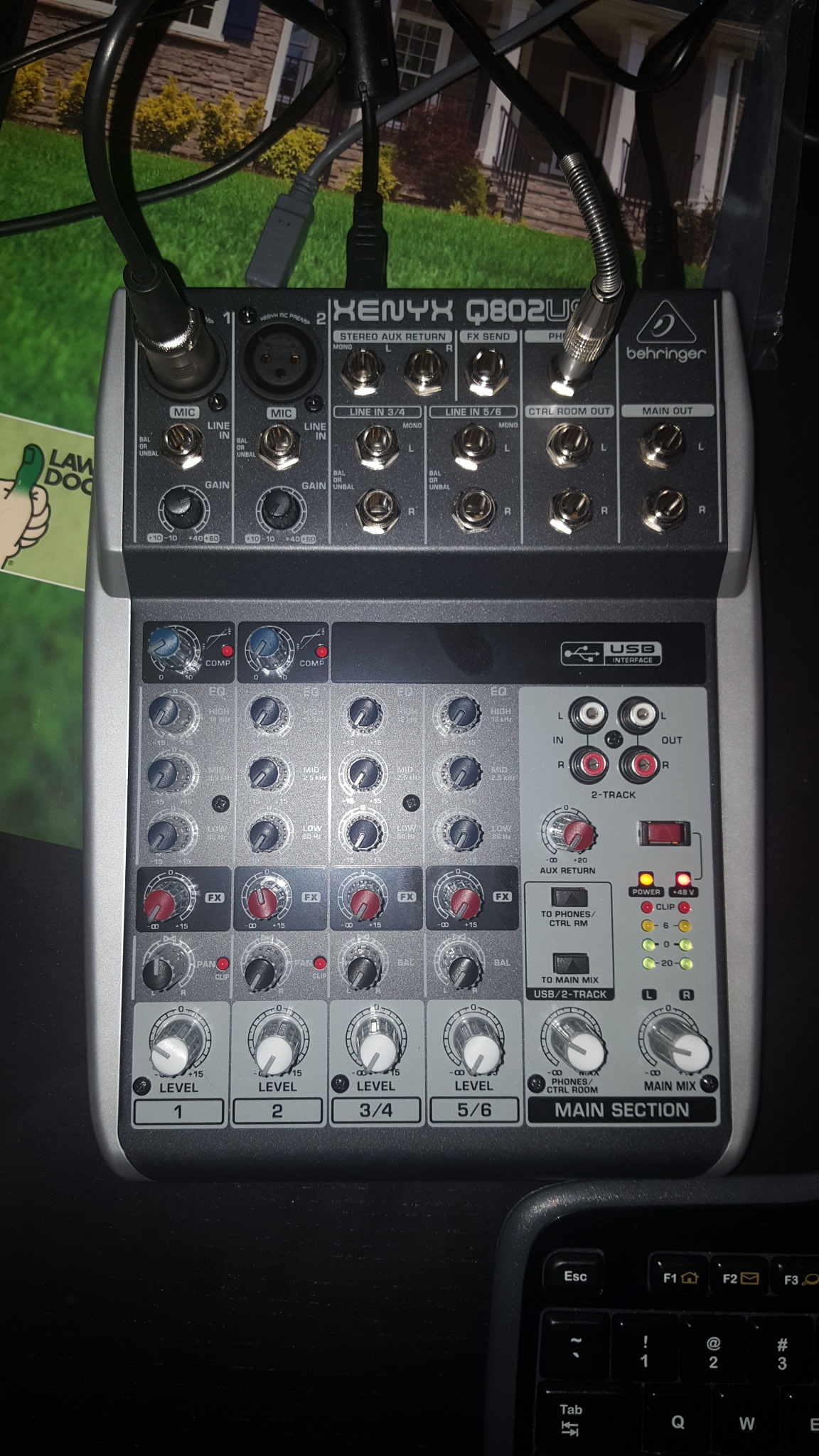

Where did the three knobs end up?
Gain 3 o’clock
Level 1 10 o’clock
Main Mix a hair over 9 o’clock.
Image provided, but for some reason it’s sideways.
I see them fine.
Post another picture where we can see all the knobs. Make sure the shot is bright enough to make out the settings. If that your phone? Does it have an auto flash?
The mixer is doing something a little unusual. Level and Master settings are lower than I expected. They work at those settings, but I wonder if I’m missing something. Remember where they are now.
Reduce the Gain (up left) to noon. See where the other two need to be boosted to give you about the same voice volume. As way up the thread, neither of us has used this mixer before, so we’re all feeling our way. Each manufacturer has little tricks that make their mixer Much Better than everybody else’s. Behringer stuff has a good reputation, so we just have to figure out what’s going on.

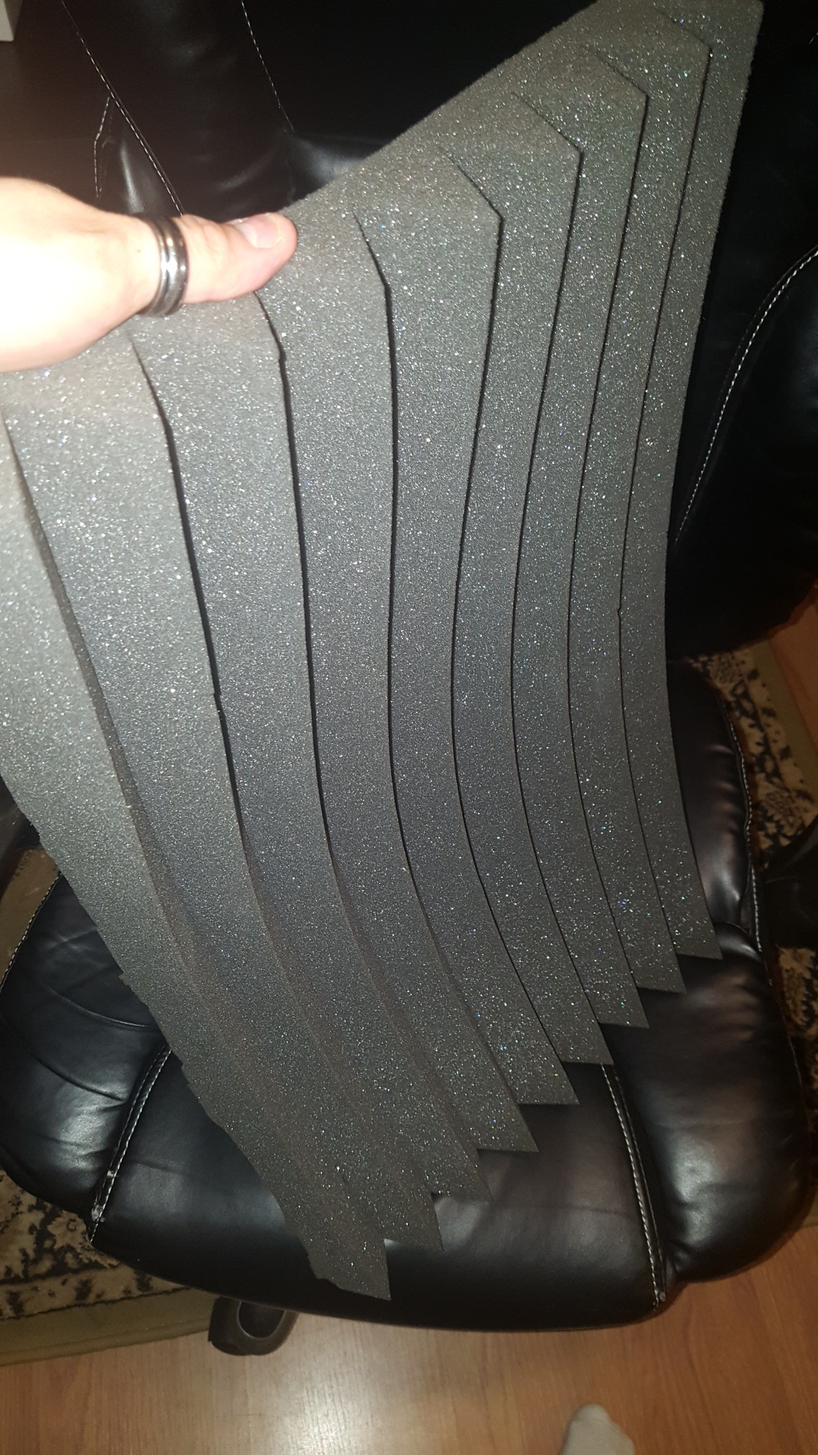

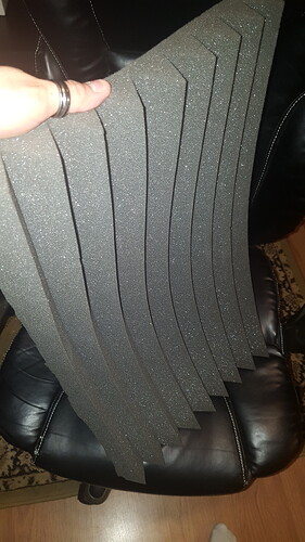

I have this type of foam. You’re saying these won’t work?

Let’s get the basic mixer working.
Plug the mic into channel 1.
Gain at around 3:00 o’clock
Compressor off
The next 5 knobs at zero or in the middle.
The compressor knob should be off, but the EQ knobs should be in the middle. All the way to the left on those isn’t “off.”
Then FX should be full left. That’s effects send. That’s if you wanted to send your voice to a processor you bought as a separate box.
How heavy is it? Real acoustic foam is heavy and like throwing a folded blanket across the room. Packing foam is designed to be light so it doesn’t cost a lot when you ship something. Anything you use will do something. I shot some voice work in a storage closet. Boxes of paper contracts make terrific soundproofing.

The three EQ knobs are tone controls. The top one is treble (crispness), the middle one is, well, midrange (roughly telephone) sounds and the bottom one is bass notes and rumble. You can add those sounds or take them away, which is why “off” is in the middle.
Compressor off
From compressor, there are 3 knobs until FX and they are now set to 0. Then FX is all LEFT and PAN is in the middle.
It’s less than a pound for a sheet that is about 14 inches wide, 24 inches long. So some weight, but a bit lighter than a blanket I would say.
Sound test!
This is on my desktop, not my laptop so not as quiet as usual but I got the clip to pass ACX-Test.
Gain at Noon, EQ knobs at 0.
I notice the fuller sound in my voice so that is cool. With that said, I still need to soundproof. I had to put moving blankets in the windows to dampen sound so I’m down to two moving blankets. Will need to order more.
But an old dude with a better microphone beat you out. You have the voice but not the microphone.
That still makes my teeth hurt. People blame all sorts of things on a bad microphone. If you submitted a voice test with your room echo, I can believe they think a better microphone will get rid of that bare, stainless-steel kitchen sound.
Your voice will be fuller and with better tones if you put the mixer EQ controls back where they’re supposed to be. It’s their job to move your voice tones around.
Gain_at_noon_…
Nothing wrong with that. I easily got it to pass ACX with a little noise reduction. It even sounds like you. I suspect it will be even better without the machine whine.

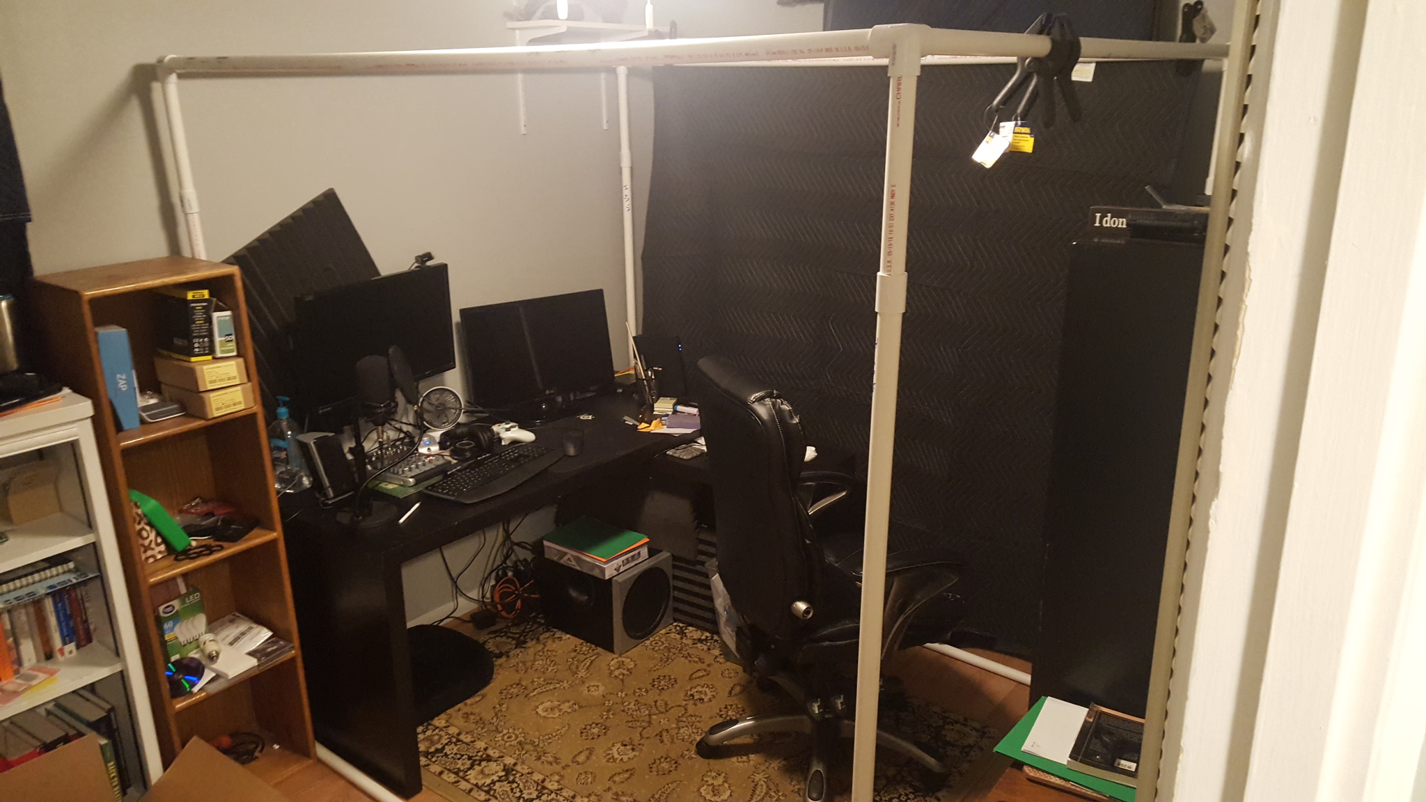

So I have a skeleton of a studio, but I ran out of blankets.
My dimensions are:
Length 77"
Width 61.5"
Height was 72"
The PVC is 1" thick, and the height pieces have couplers that can shorten the studio to 59 1/4" if I don’t need all that space. Sitting, it’s perfectly comfortable but if I needed to stand I have the option to.
Blankets are in the mail, will test again then once I have my own little Unibomber studio to practice.
So far, the PVC cost me about $50. I had to purchase some clamps at $3/pc. Overall you can build a pretty inexpensive studio in the house if you know what you’re doing.
The Home Store plastic pipes work amazingly well. They have one odd problem. Don’t leave any of the pipe ends open. They resonate with your voice and can change the tone. If you do have any open ends, stick a towel or sock in there.
I did it with complicated wooden sticks. They don’t have any problems changing voice tone.
That’s one wall.
The wooden sticks probably knock down to a smaller pile in the garage than the pipes. All these designs work well.
If you didn’t have carpeting, put one pad on the floor.
After you get into this, you can walk into your studio and hear the sudden drop in liveness and reverberation. It’s like putting pillows over your ears.
