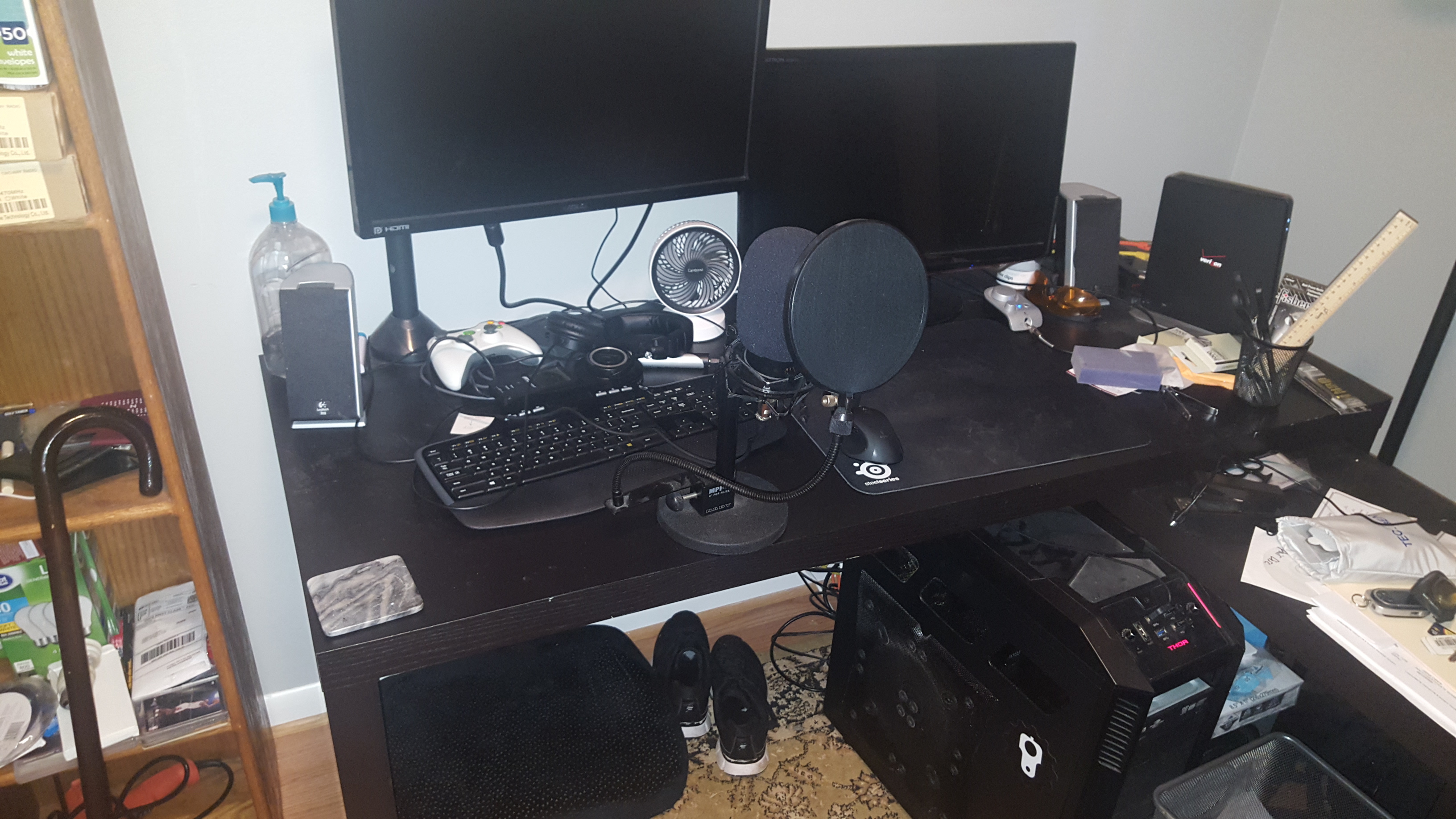

All my fans, minus the CPU and MOBO fans are on a controller, I have the controlled ones as low as I can make them go. I have a total of 5 fans on the controller and the CPU + MOBO fan.
That is most likely what you hear for the floor noise + whine.

I can hear the room. You’re announcing in a kitchen. You don’t have to go nuts with acoustic corrections and expensive panels. I made a respectable studio with furniture moving pads and sticks (two layers of pad per wall, make as many walls as you need). Each of those sticks is the same. Put any stick anywhere.
One poster did it with Home Depot plastic pipes and bedding. There’s no glue. It’s all pushed together.
Could I use the setup in your image to help mitigate with the acoustic corrections? I’d have to move a lot of stuff (not impossible) to build a cage around my desk.

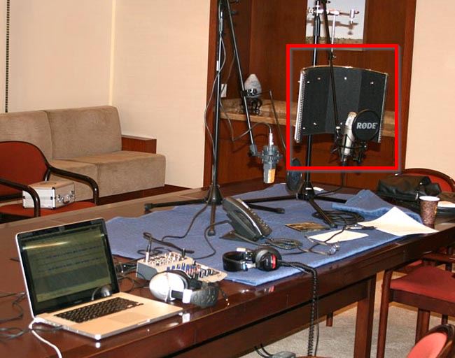

That was a Very Important Sound Shoot (Broadcast Radio Interview) so we double recorded it. The one on the right was the performer’s backup. We didn’t need the sound shield, but I didn’t really care. The conference room was totally soundproofed. Those are padded walls.
Your microphone is mostly sensitive from the front (the part facing you) and quite a bit less from its rear. That means most of the soundproofing should be behind you and on both sides.
And just to cover it. That’s a side-fire microphone. You should be speaking into the little kidney bean, not the top. That’s how this one works. That’s Chris Pratt being Emmet in Lego Movie. Upside down doesn’t matter.

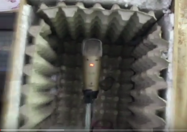

People have built cardboard box tunnels and put the microphone inside. Don’t forget the bottom.
If you do that, don’t put the back of your head toward a flat wall. Face straight away from a corner or off square a little. Doing that forces echoes to take a longer way around and be quieter.
Those are cardboard egg separators. I’ve done that. The foam or plastic separators don’t work. There’s nothing magic about that. Wadded up towels works. Heavy is good. Light packing material looks great but is actually terrible at this.
