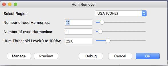

There was a hum remover tool.
Look at that. I found copy here.
de-hum.ny (2.11 KB)
HumRemover.txt (386 Bytes)
