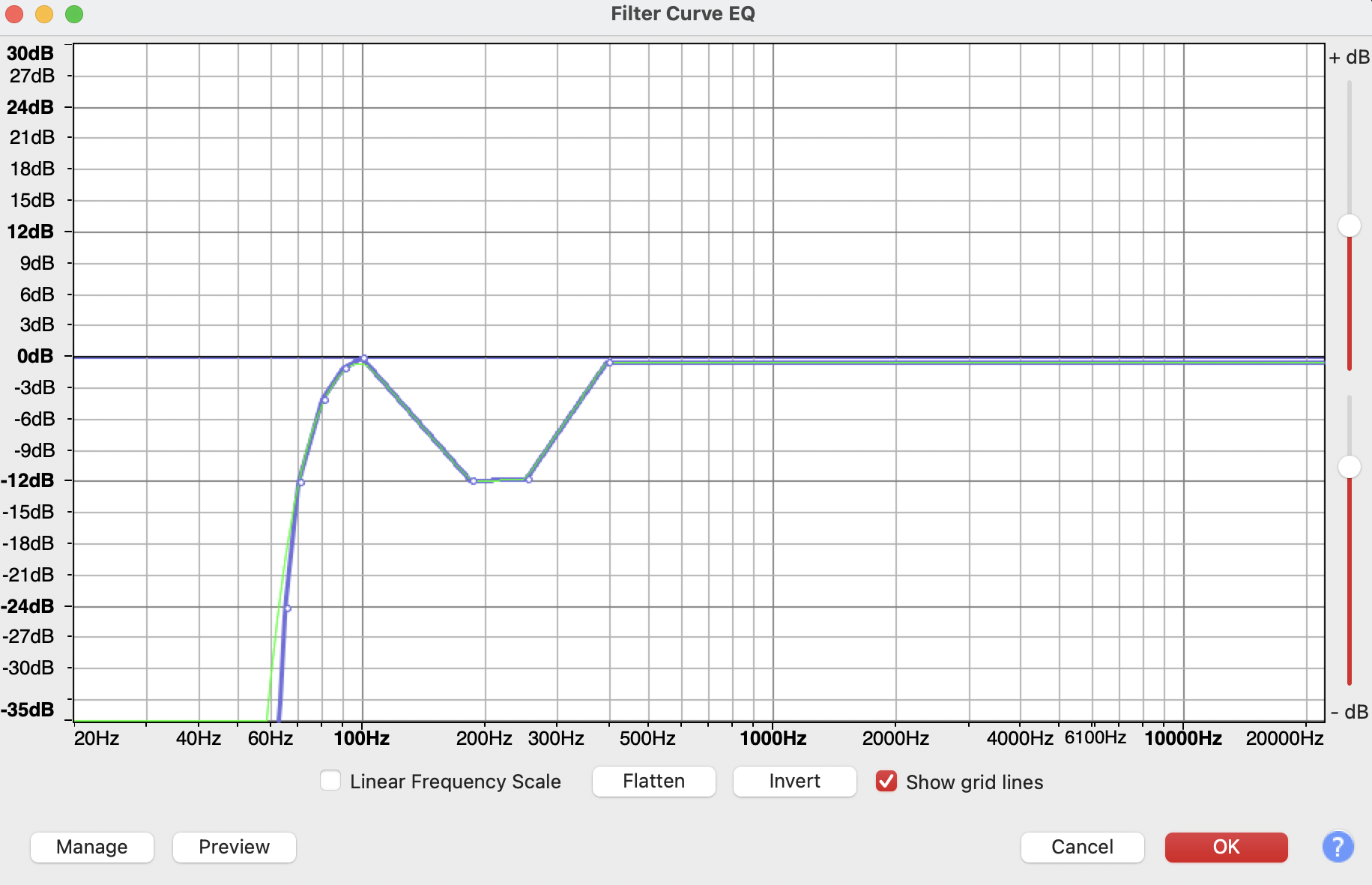

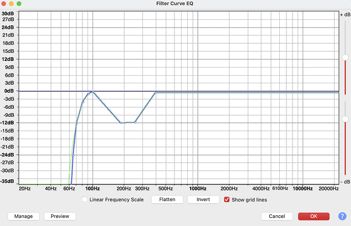

If I need different EQ filter settings can one of you post an EQ chart showing the settings. I know enough to be able to duplicate a chart.
Here’s a clip of the Timisoara Sample with the Fliter Curve EQ Effect as shown in the earlier post.
Here’s the EQ I applied.
That’s consistent with the EQ I applied to your Timisoara reading …
good EQ match

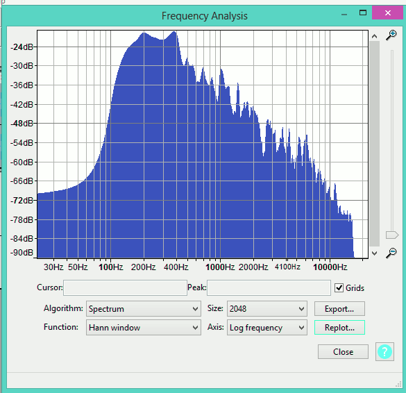

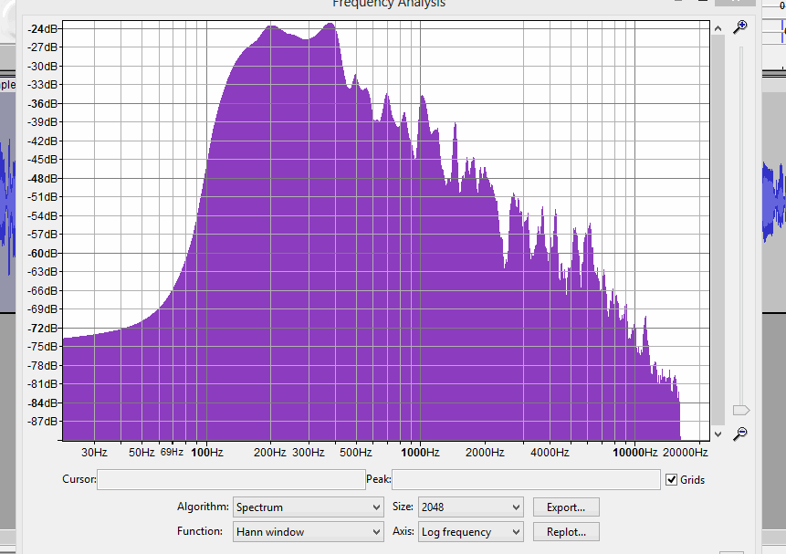

The overall slope on this purple wedge is what matters, not the fine detail.

I have an AutoEQ plugin which automatically adjusts the EQ for a male voice, and what you submitted is >90% accurate to that plugin on its vanilla ā€œneutralā€ setting: it just reduces the bass by 3dB from what you have …
U is blue, AI is Green
You blue, AutoEQ green.

If you compare your spectrum with that of popular audiobooks,
(read by men), that will show you how good your EQ is.
So if I am understanding correctly, you feel I should apply the EQ I used on the 19s sample to all of my chapters, and the result will be acceptable to a listeners ear? Should I tweak the EQ settings to make them even better. If so, how should I tweak them. Also, where in the order of Effects should I apply the EQ? On the sample I applied it after Low-pass and before Compression.

Everything recorded with the mic in that position will require the EQ adjustment you applied to sound like a typical man-reading-audiobook.

The spectrum is the objective measure of what the audio sounds like:
it is not biased by headphones/speakers/electronics/software or human hearing.

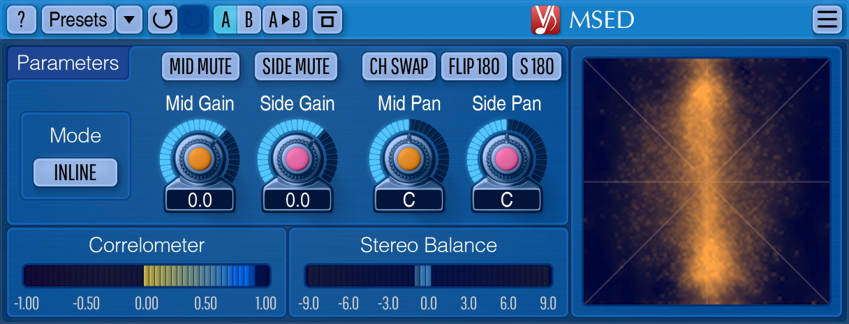

I was very interested in this plugin, however, I have already installed it and it is working perfectly.
Could you please teach me the purpose of this plugin and what it actually does or even a tutorial or booklet on it?

Mid-Side Encoder-Decoder Plugin [VST, AU, AAX] - MSED - Voxengo
But I already got the manual, but so far I don’t know what its purpose is and what it actually does.

MSED is used to adjust (and display) the width of a stereo track.
[ It does nothing for mono tracks. Voxengo have free a pseudostereo plugin for that … Stereo-Widener Audio Effect Plugin [VST, AU, AAX] - Stereo Touch - Voxengo ]
