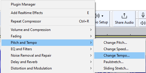

On my Audacity 3.3.2 it comes up under Effect > Pitch and Tempo > Change Tempo…
ChangeTempo
If it is not there, check that is Enabled under the Plugin Manager.
