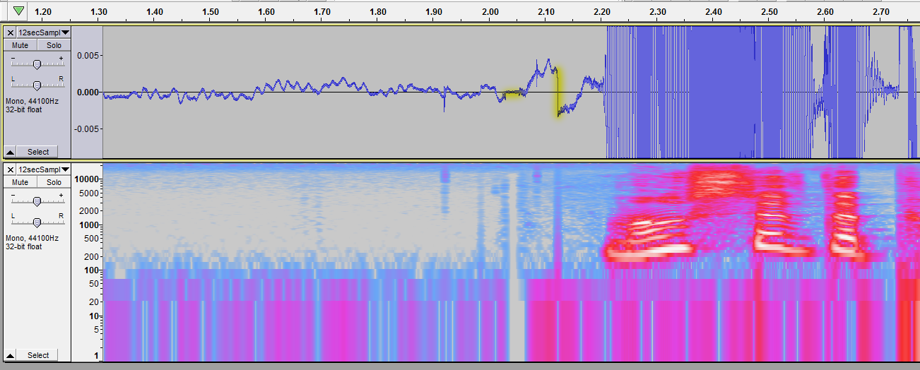

Here is my sample for review. I am interested in what effects are recommended for a chain to improve the recording. Could someone create an EQ that I can apply?

My mic is the 5th Generation Rode Nt1 and Solo interface.
The EQ is close to idea after everything below 100Hz is removed

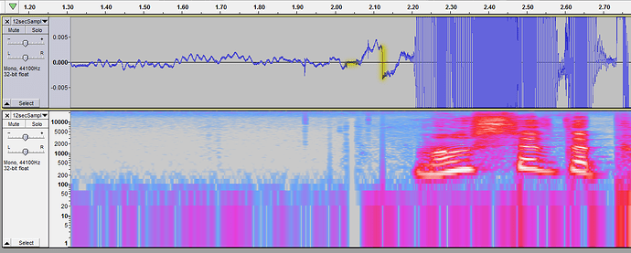

There’s a glitch just as you begin to speak …
Hi Trebor, I did the 2 second quiet then the reading. The reading was too long and I cut it out then did another recording. I joined the two using the join feature and that is probably the problem. I’ll send another recording this weekend.
