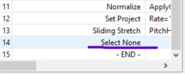

Dear specialists! After applying the effect “Sliding stretch”…(I set all the values -12 %) you can see an unpleasant surprise, it selects not an entire track, but only the part from start to length, that was before applying. I have to add a new line in Macro to continue without distortion. Please, correct immediately!
