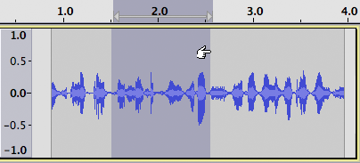

Steve, thanx for the response … the hand icon is explained in the manual (see below)
Extending or contracting an existing selection
Once you have a selected range you can move either edge of the selection so as to expand or contract the selected length, or you may want to expand the selection at one edge and contract it at the other so as to select a similar length in a slightly different place; Audacity offers multiple methods to facilitate this:
Hover the mouse pointer near the edge of a selection, when you hover close enough to the edge the mouse pointer changes to a hand with pointing finger (indicating you can now click and drag the selection). Then click and drag with the mouse to move that edge of the selection.
Classic theme: selection extended, mouse pointer displaying as a hand with pointing finger.
If you want to turn off that feature, open Preferences, choose Tracks then uncheck “Enable dragging of left and right selection edges”.
So I went to Preference, Tracks, etc and unchecked this feature. The hand icon is gone but the problem remains … when I click on a wave, it still won’t let me slide the cursor back over an item and delete. It still wants to slide back over at least several words ( a ‘range’ to use the term in the manual)

This one I assume:
(On Linux it’s an arrow rather than a hand)
I’d suggest that you change that back.
My guess is that you have accidentally enabled “Snap To” (near the bottom of the main Audacity window). Set it to “Off”.
