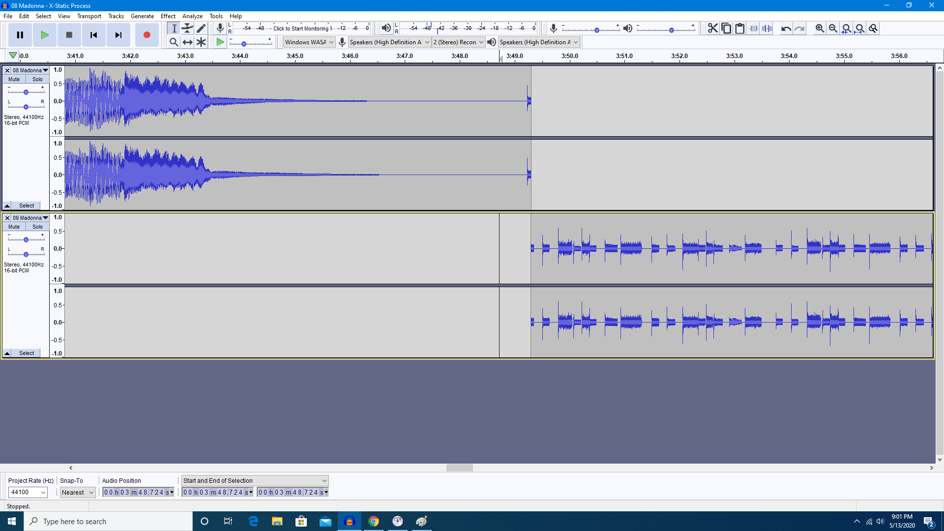

I am attempting to repair some music files that are incorrectly mastered. What I mean by this is that there are incorrect track boundaries on certain CDs I own and therefore my rips need to be edited. In the screenshot below, you can see how the beginning of a track is attached to the track that comes before it on a CD.
What I want to do is take the sliver of audio at the end of the first track and attach it to the second track so that the second track starts correctly. I know the sliver looks small but I realize now that if I zoomed in more, you could really get a feel for how big it is and it is 100% audible when I shuffle my music.
I have read in other threads that I need to disable the dither feature to ensure that when I export the files, they stay the same as their originals. Is it possible to make the edits I want to make and keep the file quality in tact?
Thanks for any help.

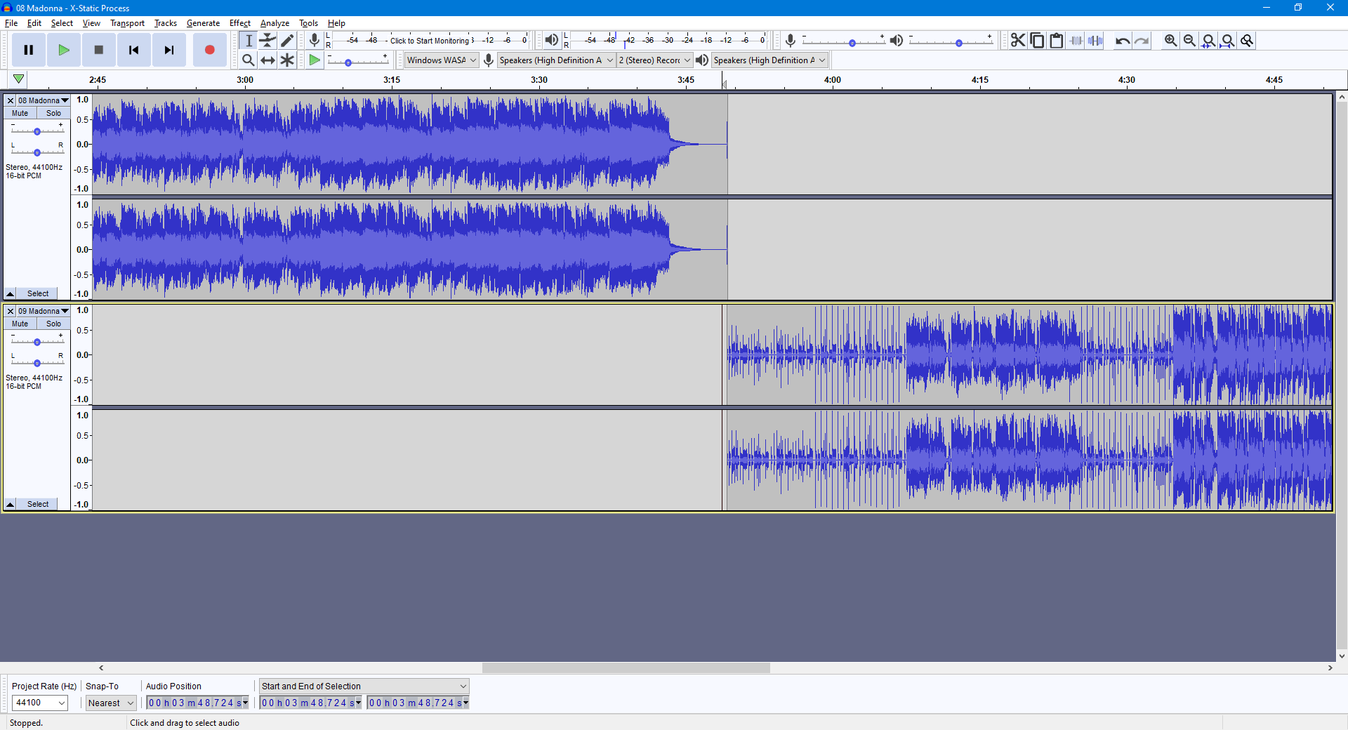

Here is a better visual to help you see the extent of the mastering error.

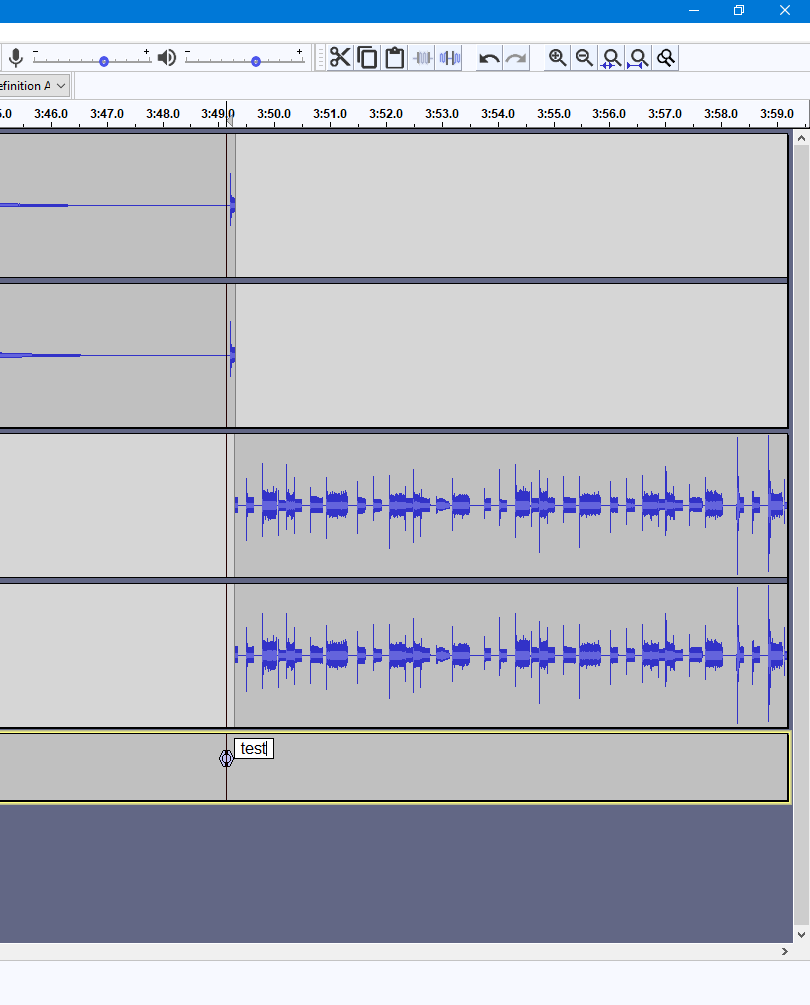

You can now add a “Label” at the start of each song (including a label at the very beginning for the first song). Then you can “Export Multiple - based on labels” to create new files that start and end at the correct places.

Very cool. So you’re saying that if none of the tracks overlap in alignment, then they’re fine?
Looking at this screenshot, does overlap mean that one of the songs, in its own respective track, would be placed over the other one?

That is very interesting. I do not plan to overlap the tracks. I’m just going to do as you said and introduce labels to signify where I want the track beginnings to be. I am also not adding any effects because I’m trying to get files as close as possible to what the CD is supposed to be. All the files are regular 16-bit AIFFs.
In that case, temporarily turn off dither.
