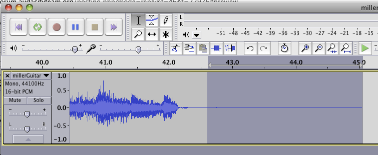

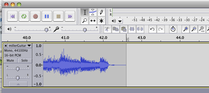

Drag- select an area bigger than the portion you want to sheer off and Control-E Zoom In. Then drag-select the flat blue waves (silent lead-in or lead-out) but leave a little of it still attached to the show (illustration – the light portion will remain). Press Delete. Zoom out Full with Control-F. Do that at both ends of the show. Then Export the WAV or MP3.

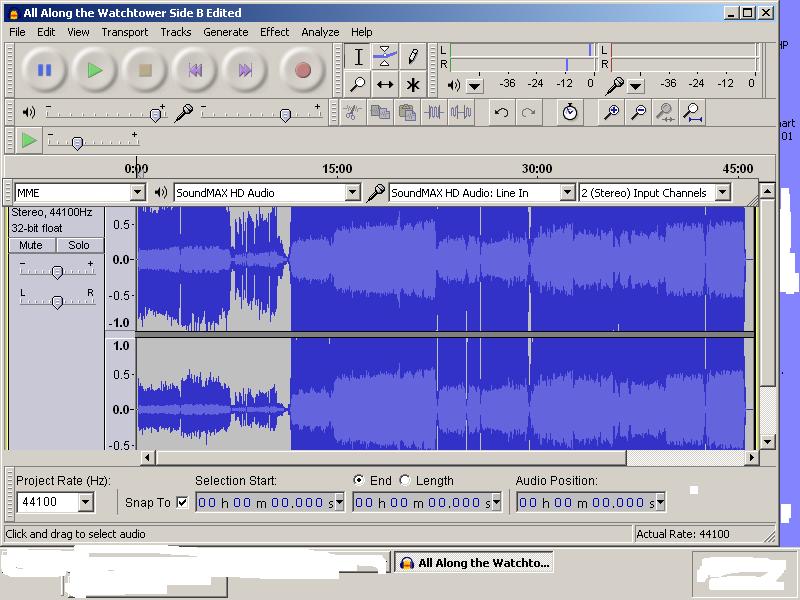

Hi Steve,
I’ve done a printscreen saved as a jpg.
Hopefully, you can see how the line begins to the left of the second zero and then goes past the third zero and starts playing music.
Thank you!
Deselect “Snap To” http://manual.audacityteam.org/o/man/selection_toolbar.html#snap
(this should normally not be enabled - it is off by default).
Zoom in closer on the waveform: http://manual.audacityteam.org/o/man/zooming.html
Press the “Home” key on your keyboard. This will take you to the very start (time zero).
Hold down the shift key, and while holding it down, click and drag on the waveform to just before the start of the music. Release the mouse button, then release the Shift key.
Press the Del key to delete the selected region.
