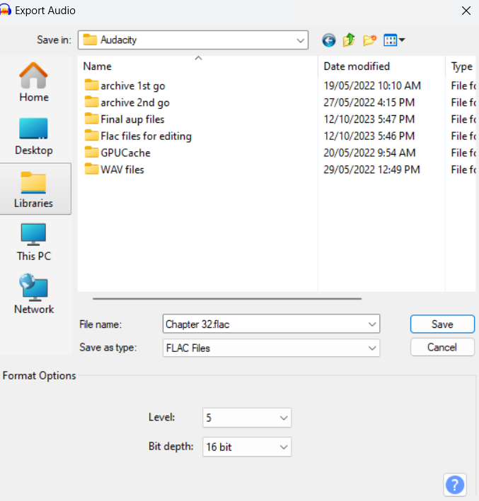

Thank you DVDdoug. Problem is, it’s not giving me the option of FLAC.
And it’s defaulting to level 5 and bit depth 16 bit. I’m sorry, I’m way out of my depth here, but I don’t want to go back to my audio engineer friend cos he’s a bit under the pump right now.
In FLAC format the compression level makes no difference to the audio quality, it just determines the file size, ( I use level 8: it makes the smallest file size).
Using 24-bit depth rather than 16-bit does not make an audible difference, IMO, (it will make the file bigger).

Thank you Trebor!That’s really helpful.
