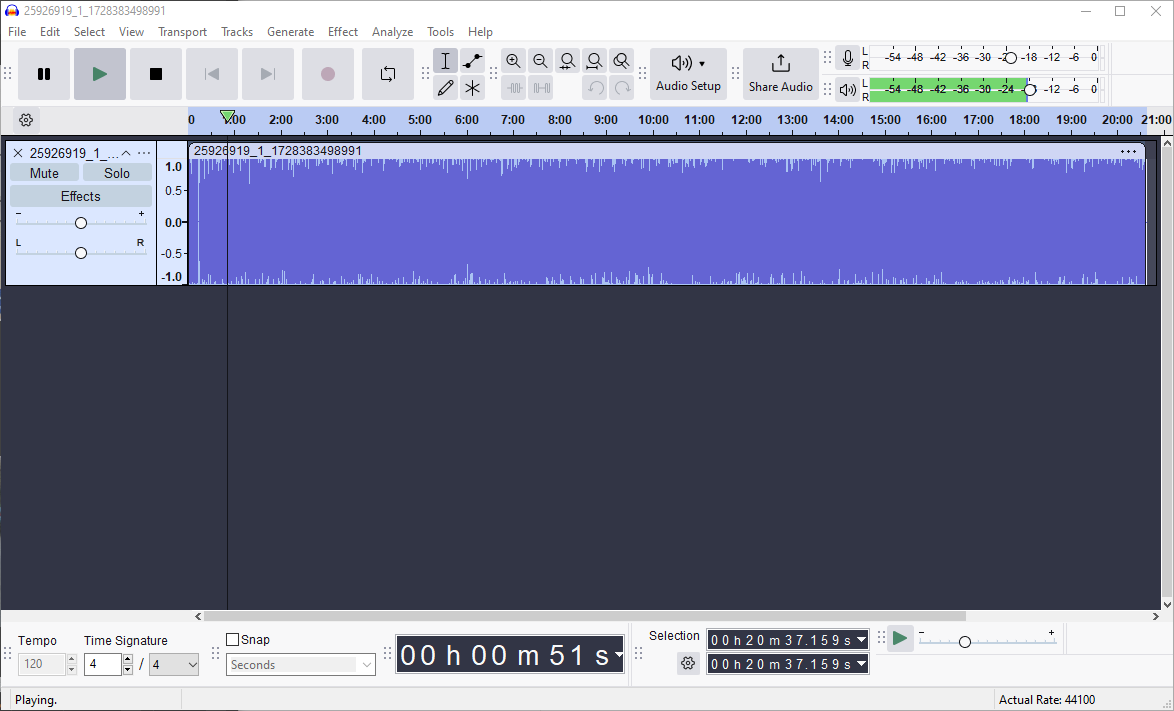

I recently downloaded the 2.0.3 version .exe installer.
I have been openly recording conversations between my grandmother and myself on my android for with a “phone call recorder” app.
when I play back the conversation on my home computer I can hear myself loud and clear, but her conversations is not so loud .
I want to know how can I use Audacity to lower the volume on my voice and raise it on her voice.
Thank you…please spell it out in real basic terms, step by step. As I am new to this.
The best way is to painstakingly go through using the Envelope Tool to adjust the volume up and down. http://manual.audacityteam.org/o/man/envelope_tool.html
If you want a quicker way, you could try this “Automatic Gain Control” plug-in effect: https://forum.audacityteam.org/t/agc-automatic-gain-control/26706/1

In addition to the Envelope tool, I would also highlight your grandmother’s voice waveforms, and use Amplify on the Effect menu. Since you can see how soft her voice is, you can set the boost amount and keep it consistent. Make sure not to check the box that says “allow clipping”.
After which, if there’s still some discrepancies, highlight the whole conversation and Normalize everything (Effect–Normalize, set peaks at -2 to allow for sufficient headroom).

When you have downloaded the agc.ny file, put it into the Audacity Plug-ins folder. On Windows computers, this is usually under “Program Files”.
Then restart Audacity. The AGC effect should then appear in the Effect menu below the dividing line.
