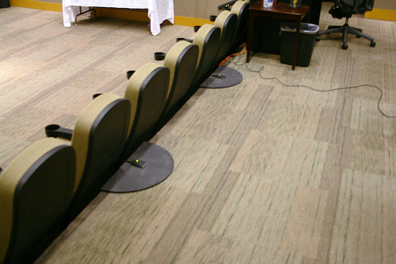

There are a few other tricks as well. Do record in very good quality stereo. Even terrible recordings are much more acceptable if you can locate your performer in space while you’re listening. This was a trick we did with theater recordings to capture reviewers voices during a show. Nobody is going to mic 28 people, but the three stereo microphones worked remarkably well (Attached for two of the three microphones on the floor). The screen is to your left. Row two with the reviewers just to the right.
I got blowback from the IT Systems people as to the “wasteful nature” of this technique until one of the production people discovered she could easily transcribe two different people talking at the same time with these sound files.

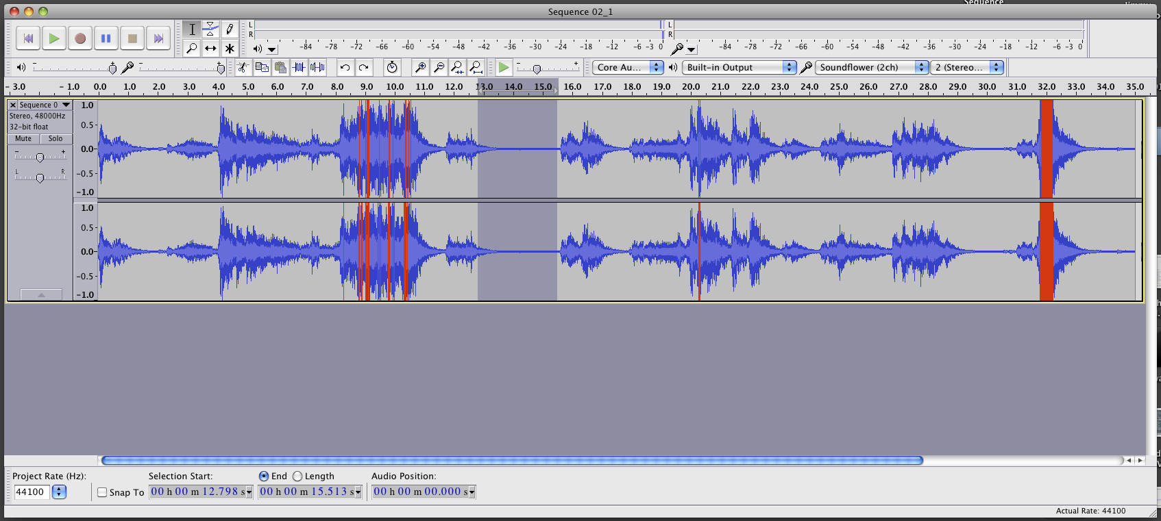

Import the clip you sent me into Audacity. Once you do this the first time, the settings should follow you when you apply them to much larger clips (assuming you don’t change the room).
Select the sound that Audacity is going to use as the Profile or echo sample. The first picture shows a small gray segment selected. See the start/stop numbers at the bottom of the frame. Effect > Noise Removal > Profile.

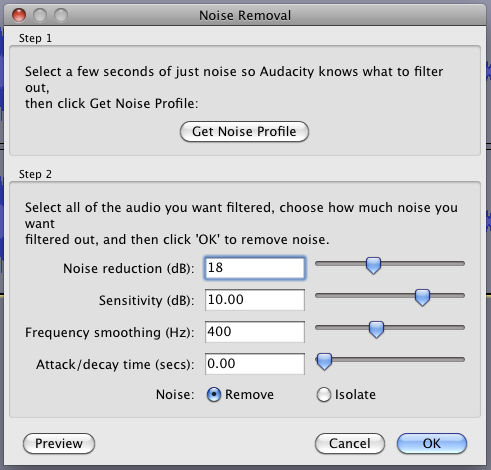

Then run Noise Removal for real. See the second picture with the noise removal settings.

Fair warning the first Noise Reduction setting, Noise Reduction (dB), is a juggling act between velvety quiet backgrounds and tinkly voices. Sometimes you need to keep a tiny bit of noise in to also keep the performance quality.
