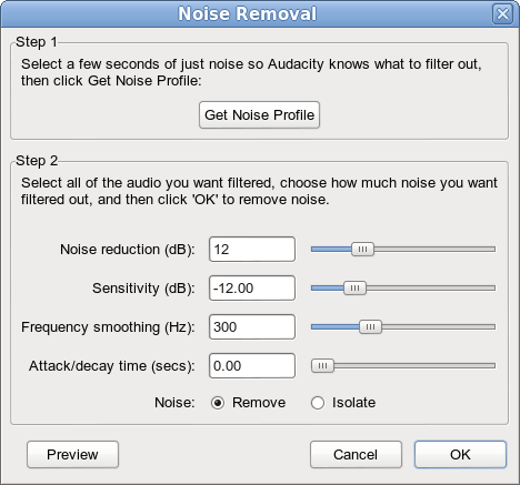

  3. Apply the Noise Removal effect with these settings:

Since you used The Voice as the Profile why does the voice itself not vanish?
Good question. It’s because the “Sensitivity” control is set very low. Thus the Noise Removal is looking to remove sounds that are “like” the voice, but quieter. The echo/reverb is very much “like” the voice (it IS the voice) but is quieter than the direct voice sound.

thank you for your help Steve, it works… :smiley:

Is the increase in frequency smoothing / reduction in attack / decay part of the general recommendation, or specific to this voice?
Smoothing may be the key to this. What that control actually does is define the amont of voice that makes it through unaffected. Koz
If “Smoothing” is too low you will hear the typical metallic artefacts of FFT processing.
I just increased the smoothing gradually until there was no appreciable improvement regarding that metallic bubbly sound.
The key to this is the “Sensitivity” control. That controls how much of the voice “slips through the gate”. It works like a “threshold” setting on a noise gate. The higher the setting, the less gets through. The idea is to set the “threshold” (Sensitivity) so that the direct voice gets through with little change, but that the reverb tail (echo) is attenuated. In effect this is working like a noise gate that is tuned to the frequency spectrum of the voice.
“Attack/decay” controls how fast the gate opens/shuts before/after the level crosses the threshold. If the input has a very long reverb and you want to make it shorter, but not to stop it altogether, you can set this to the length of reverb that you want and the reverb will decay from the level at which it crosses the threshold to “nominal silence” in the decay time set.
