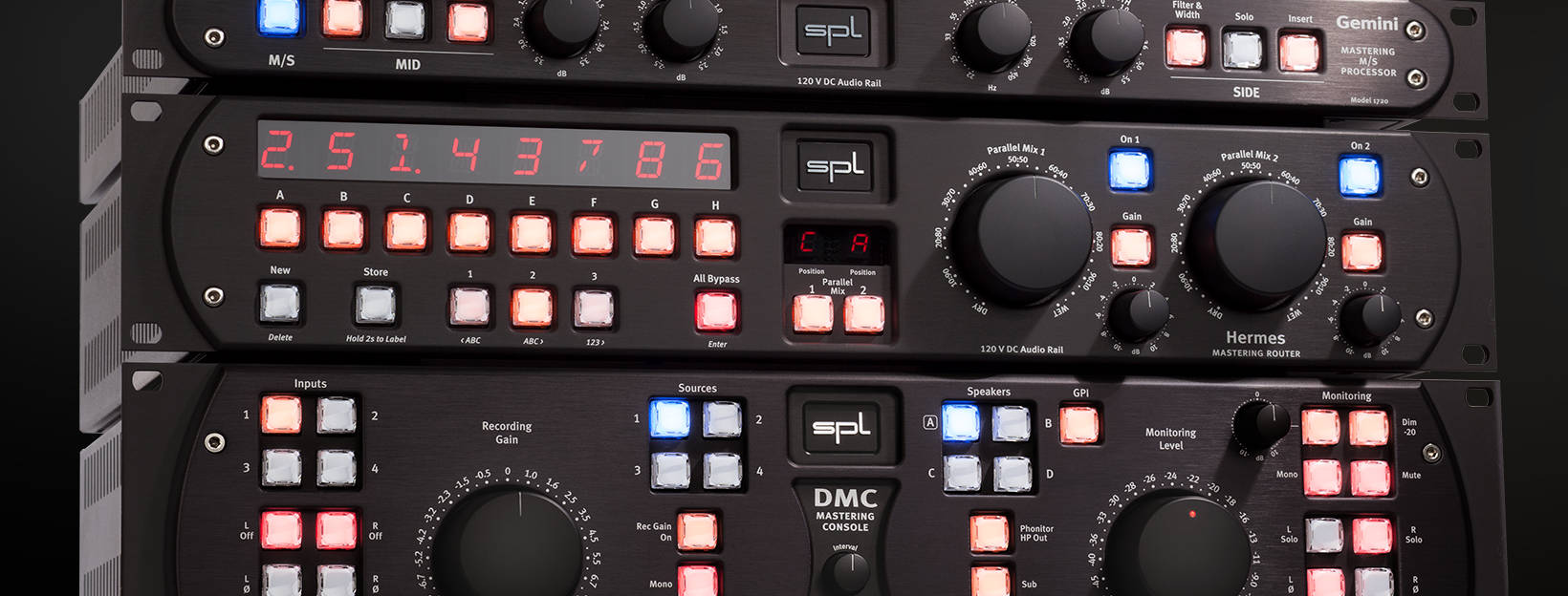

In theory, deconvolution if you have a good sample of the reverb, with as little of the original sound as possible:
SPL De-verb (Windows VST and Mac VST/AU):
