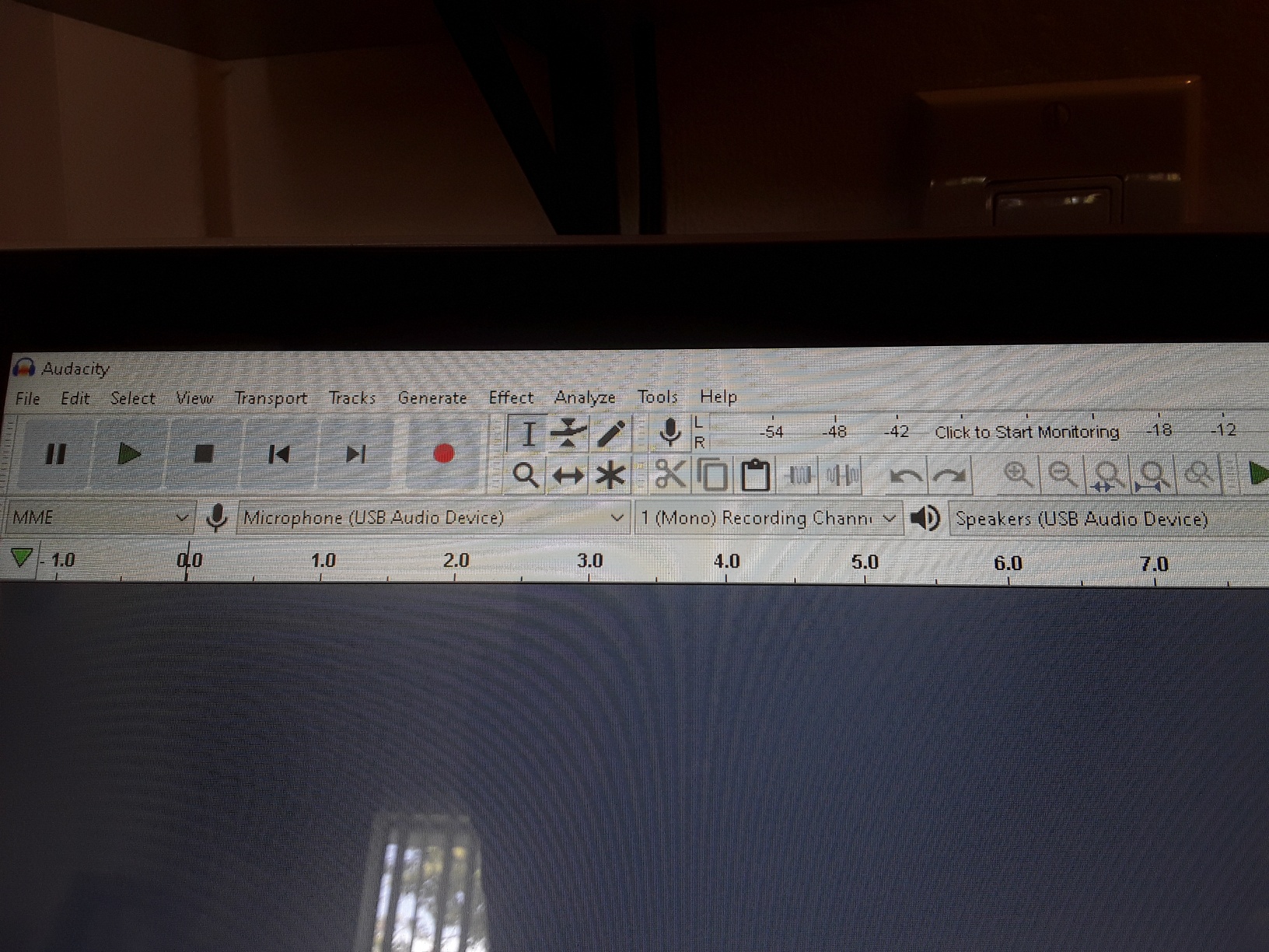

In the Audacity recording device (microphone symbol), make sure you’re recording from something you can reach over and touch. A real thing. When I do this, I record from “USB Audio CODEC” which is the name of my Behringer UM2 interface. That’s it on the left. It’s real.
If you like to record internet music or other shows, chances are terrific you’re not recording from a real thing. You’re recording from a software redirection program or app.
What is your microphone, interface, or device and how do you have it connected? What does the Audacity microphone symbol window say? Describe the performance.

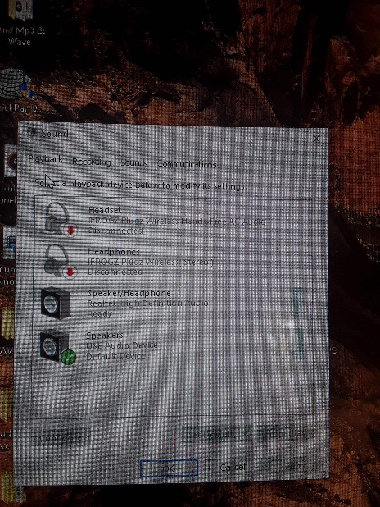

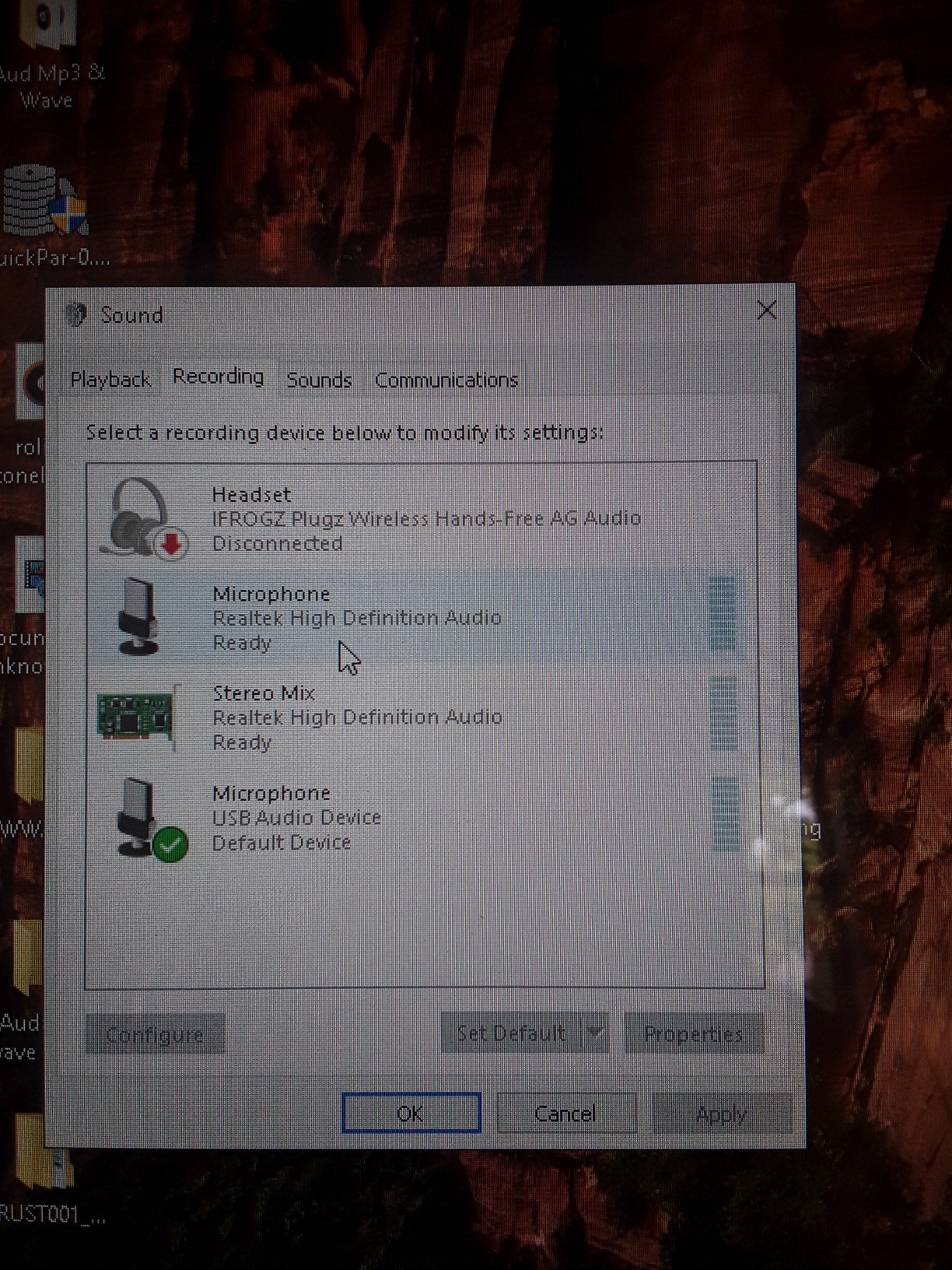

Yes on the first. The drums are on track 1. They are recorded from a drum machine through my interface/ Moukey MSc1. When I record guitar on track 2 , the Drums record again with the guitar. Yes on the wired headphones. I have a voilamart bm-800 microphone/ moukey MSc1 interface going through windows 10.
