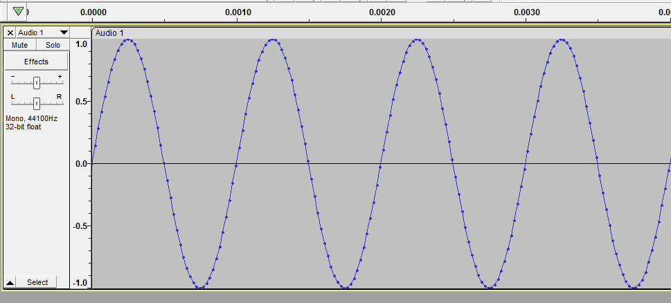

If the 1000Hz sine wave goes from +1 to -1 then it’s “0db” .

There’s a better way to check the amplitude - Run the Amplify effect. It will default to whatever positive or negative change needed for 0dB peaks. For example, if it shows +3dB your peaks are currently -3dB. If it defaults to zero dB (no change) your peaks are already 0dB.
You can cancel the effect if you don’t actually want to change it, or you can “normalize” it to 0dB or whatever you want.

FYI - Audacity can generate tones (sine waves & square waves and a coupled of other shapes).
When I tried the amplify effect, it gave me a reading of -.088 for the new peak amplitude to be 0db, but it still was showing 6db on that analyzer :face_with_raised_eyebrow: However, I mixed the stereo tone to mono, and the db level is now at 0db, exactly as stated on the file download!
