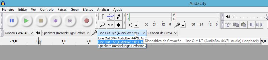

As the attached image in my audacity appears the “WAPASI” but only appears the options regarding 44VSL:
  • LINE OUT 1/2
  • LINE OUT 3/4
When you choose one of these options can record one channel audacity using 2 channels of 44VSL. Only a 44VSL channel goes to the right and the other channel goes to the left of the estero single channel audacity.

You could try Audacity 2.0.4 and WDM-KS host (with the warning I mentioned). If you were to disable the built-in sound device in Windows Device Manager before trying 2.0.4 that should minimise the risk.
You could overdub - record tracks 1 and 2, then play tracks 1 and 2 while recording tracks 3 and 4.
You could record in an ASIO-enabled app like Reaper (free trial) or Wavosaur (free) then edit the recording in Audacity.
If you want to try compiling Audacity, see the yellow box at the top of http://wiki.audacityteam.org/wiki/Developing_On_Windows. The file win/compile.txt mentioned there explains how to enable ASIO support when compiling Audacity.
