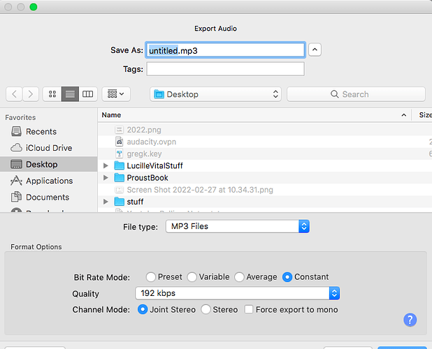

Audacity Export should show you quality settings.
You can’t easily export MP3 in the same quality that you imported it. MP3 gets its small, convenient files by re-arranging tonal values to be more efficient…and leaving some of them out. It does it at every export and you can’t stop it. You have the option of Exporting as perfect quality WAV or super high quality MP3 and just put up with the small damage.

I’m on windows 11 and there is not mp3 quality options on the export window
Does Win11 still have the Snipping Tool? Take a picture of the panel you do have and post it. Scroll down from a forum text window > Attachments > Add Files.
