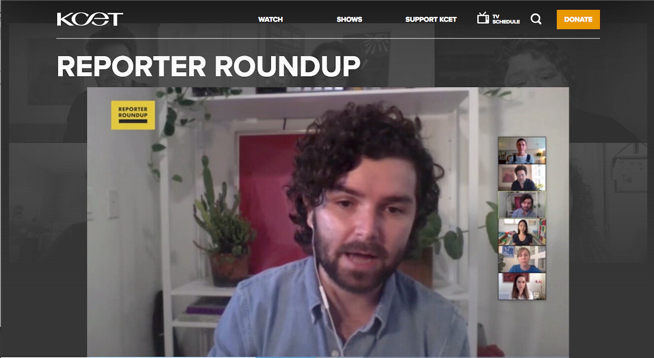

You are experiencing a Movie/Television oddity. Nobody pays any attention to the sound until it stops working. Without the sound, you can all go home.
Here’s another one. These people’s voices tend to survive a lot better than the people that insist on announcing into the room cold—in the general direction of the computer.
