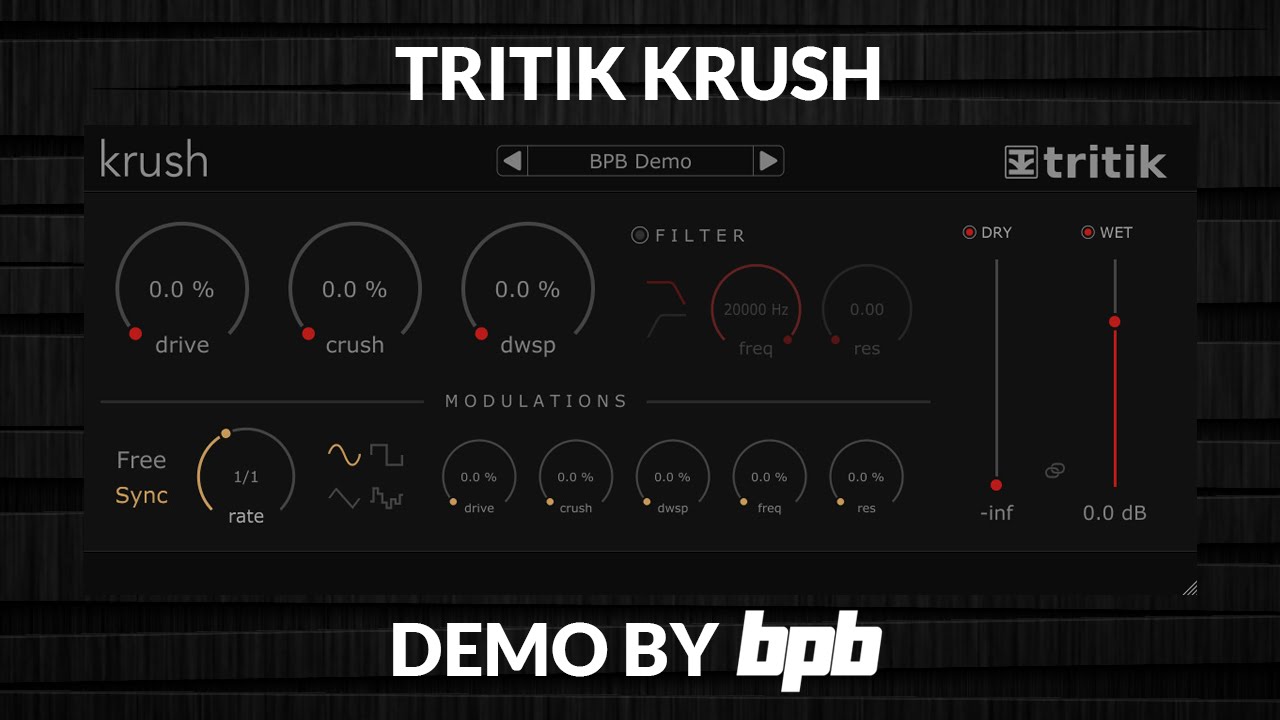

A similar effect could be achieved with a bit-crush plugin.
Tritik Krush is free & works in Audacity on Windows …

Tritik Krush does also downsampling as well as bitcrush.
dBlue crusher is a free plugin which has a downsample slider, independent of bitcrush.

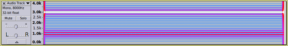

Example, If you generate a sine tone at 5 kHz and resample to 8 kHz, the Nyquist frequency is 4 kHz. “Proper” resampling (with anti-alias filtering) will remove the 5 kHz sine tone and the result will be silence. Resampling without anti-alias filtering will create a strong peak at 3 kHz (the alias frequency).
The code I provided will also create additional frequencies at a much lower level. These are the result of “distortion” cause by the linear interpolation.
The problem is the sheer act of selecting 8khz in the drop down after using the nyquist command does the exact same effect as just selecting resample and selecting 8khz. The dblue crusher also doesn’t allow for a specific sample rate, just a number of sample reductions
No it doesn’t.
When you select Resample, the audio is resampled by “soxr” (a high quality resampling library) which applies anti-alias filtering prior to resampling.
With the steps that I posted, the audio is resampled by Nyquist using linear interpolation and no pre-filtering.
Try the comparison that I described in this post: Disable automatic low pass filter when resampling - #14 by steve
You will see that Audacity’s resampling (using soxr) produces silence, whereas Nyquist’s “force-srate” produces an alias 3 kHz waveform.
