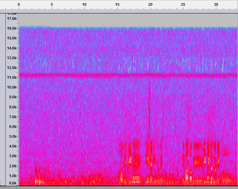

Spectrogram of the same audio before and after:
Here is that first part of the Voice.mp3 with the noise in spectrogram:
And after noise removal in the second part of Voice.mp3:
You’ve used the right type of tools, but you’ve dialled-in too much noise-reduction IMO.
Noise-reduction always does harm, use sparingly.
In your example some level of hiss is inevitable if you want to avoid conspicuous damage to the vocal …
